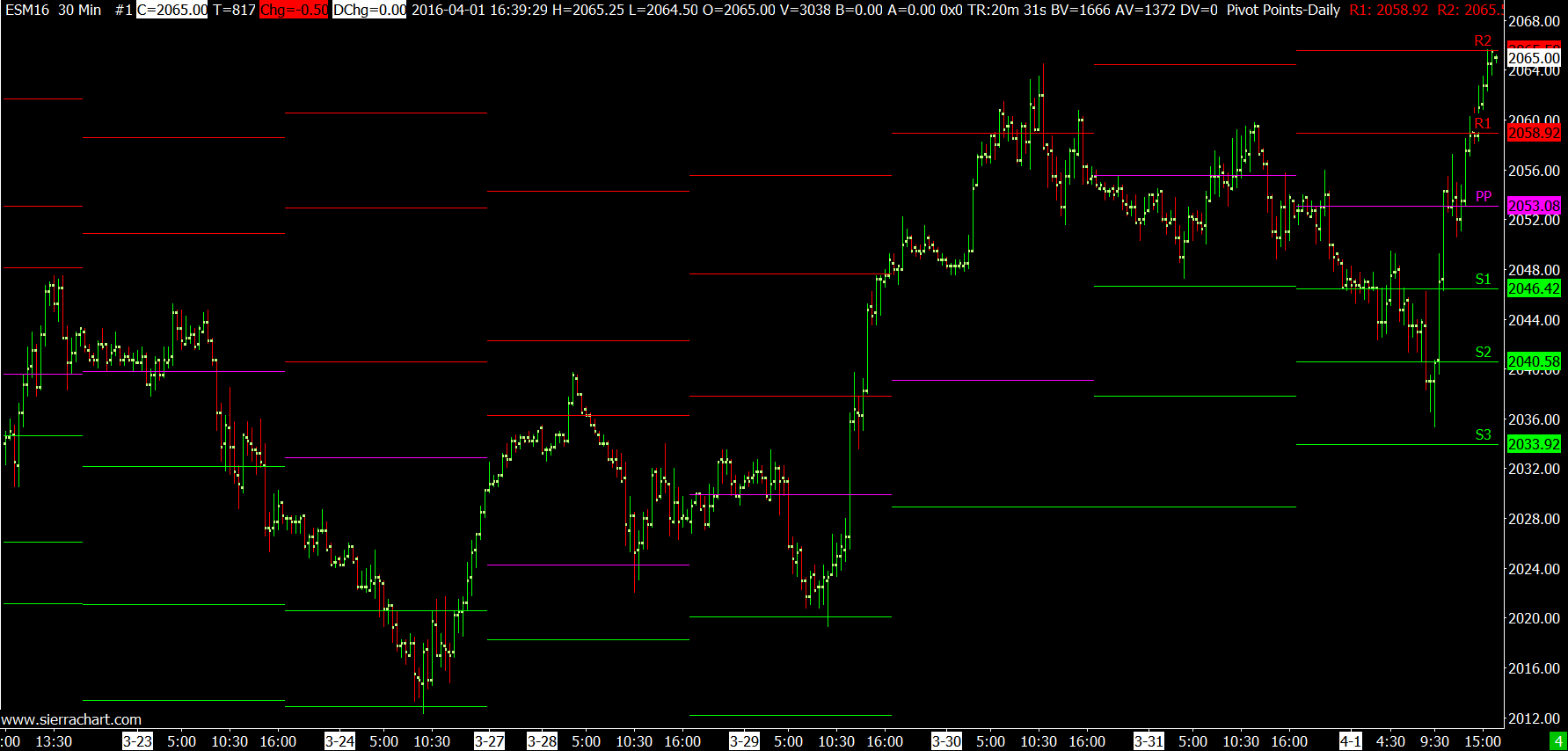

[2016-04-01 20:41:44]
Using these exact settings, the Pivot Point lines are correct:
http://www.sierrachart.com/image.php?l=1459543287725.png
