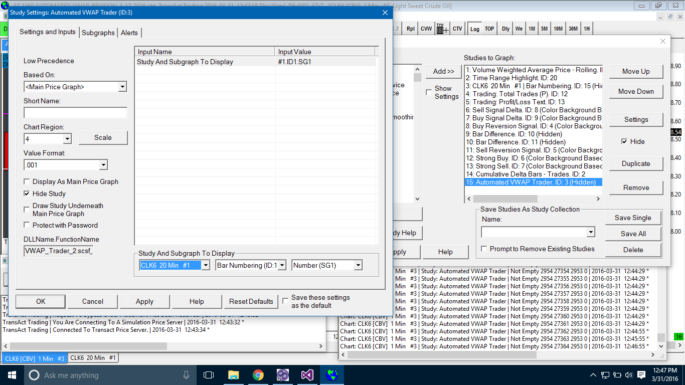

[2016-03-31 17:55:20]
User786661 - Posts: 5
The Input Values were incorrectly set so I've changed them to the correct values you see in the picture (Note: The chart I am attempting to reference has changed over night from #2 to #1).
In the bottom right my message log is showing that the array receiving the subgraph data is no longer empty. It holds 2954 elements, my main chart's current index is 27364, the "nearest index" (found with sc.GetNearestMatchForDateTimeIndex(1, sc.Index) was 2953 which all appears to be correct however all the values in the array appear to be 0.

[2016-04-08 01:00:37]
We do not provide programming help.
[2016-04-08 01:02:13]
Although we did check to make sure that the Bar Numbering study does fill Subgraph at index 0 with the bar number values.
[2016-04-08 01:04:05]
Another thing to consider is study calculation precedence/order:
Chart Studies: Study Calculation Precedence And Related Issues
