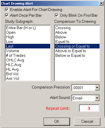

What I mean it is to add a box where we would be able to input the maximum number of times that that alert will trigger before it is disabled and stops sending alerts. --> (Please see attached image)
This is useful when using alerts in lower timeframe charts and specially if those alerts are linked to an email (getting 50 or more emails due to an alert is not fun)
So for example, we set an alert to a horizontal line or to a study on a 1 min chart. We also tell the alert to trigger a maximum of 3 times. (As in the attached image)
Once price, on the 1 min chart, reaches the level it will trigger the alert for the first time, after, a new 1 min bar triggers the level for the second time, finally after a new 1 min bar reaches the level it will trigger the 3rd and final alert before the alert is disabled and won't alert anymore as the counter has reached the maximum number of iterations set of 3.
Do you see how this could be useful?
Would this be something that could be implemented in a future release?
Thank you for your help
Date Time Of Last Edit: 2013-07-30 13:45:19
imageAlert Limit.jpg / V - Attached On 2013-07-30 13:39:15 UTC - Size: 43.97 KB - 869 views
