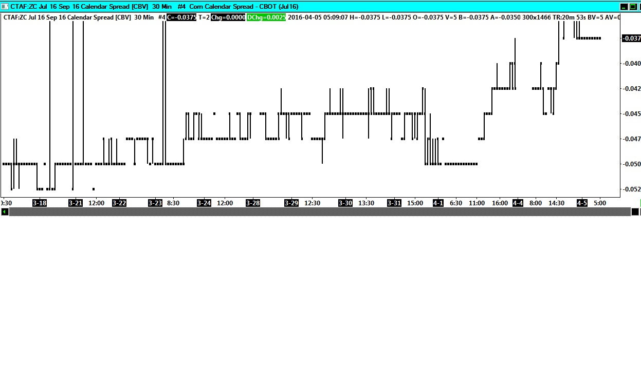

I already seem to have the data for all that, would there be any additional cost? I can see some anomalies in the data, I.e. a spike in prices on the charts.

Sweet, that would be good then, attached is the July 16 December 16 Spread.

We do not recommend using the Continuous Futures Contract feature with spreads because it will not work properly.

The reason for the inaccurate prices, spikes that you see, has been determined and we will be cleaning up the data over the next few hours. It has to do with the confusing data format of the prices from the data feed.
Really it is completely wrong how the data is transmitted and this should not be considered an acceptable format. For example -22 needs to be converted to -20025. The 2 at the end is 2/8 of a cent
After this is done you will need to re-download the data in the chart with Edit >>Delete All Data and Download.
