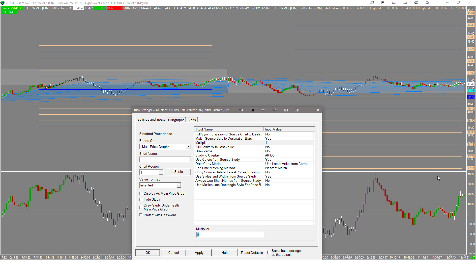

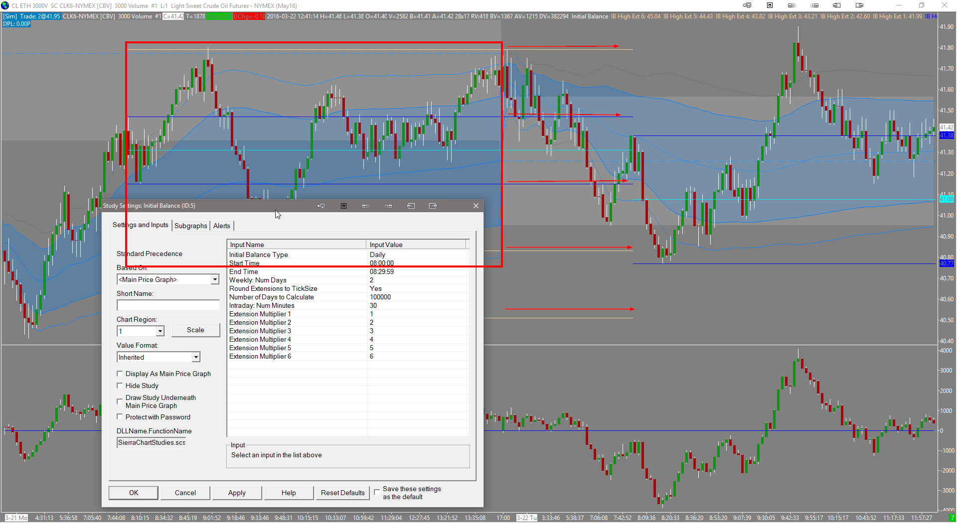

how can i get the IB study to plot to the end of the session and not all the way to the start of a new IB on the next day? i have tried overlaying the IB i have on an RTH chart to the ETH chart but i get some funkyness as you can see in the second picture. i would use the "High/Low for Time Period - Extended" study but you then cant plot the IB mid or extensions among other things.

This study is designed to plot from the Initial Balance time all the way up until that same time the next day.

i think that this needs some way to end it from doing that if you want when you have a full session charted. i know the docs point to using the "High/Low for Time Period - Extended" for that but then you lose out on the midline and extensions which are a big part of an IB study.
