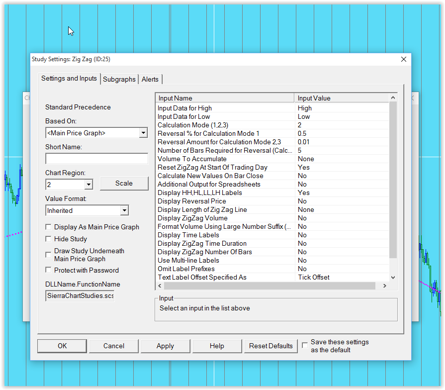

[2016-03-24 02:30:07]
toews&kane - Posts: 209
Here is a screenshot of the settings
I would be very grateful if you can tell me what I am doing wrong, because I've spent too much time trying to get this to work.
I have the same settings on another chart (symbol) and it works fine
The above is a 5 min chart btw, thanks in advance
imageScreen Shot 03-23-16 at 10.28 PM.PNG / V - Attached On 2016-03-24 02:28:58 UTC - Size: 60.2 KB - 401 views
[2016-03-24 02:54:09]
It does appear there is a problem we need to look into but once again tthe image in post #12 does not meet our requirements.
Provide an image following the instructions here and only use the method documented:
Follow through each of the steps.
[2016-03-24 03:00:40]
Actually, we realize you have set the input to reset the Zig Zag at the start of the day. So you will not see a label at the start of the day and at the first reversal.
And at this point, what exactly is the problem? We need a clear description based upon how the calculation method works.
Date Time Of Last Edit: 2016-03-24 03:00:54
