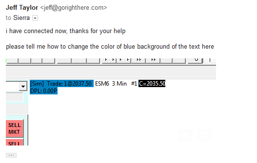

Hi
please see attached,
thanks
J
imageCapture.PNG / V - Attached On 2016-03-21 19:44:53 UTC - Size: 9.77 KB - 459 views
imageCapture2.PNG / V - Attached On 2016-03-21 19:45:01 UTC - Size: 30.93 KB - 551 views
[2016-03-22 05:05:21]
1. Refer to this page here:
Customizing Fonts, Colors, Line Styles, and Widths for Chart Trading, Chart DOM, and Trade DOM
That particular item is called the "Chart Trade Mode Box".
2. Refer to:
https://www.sierrachart.com/index.php?page=doc/doc_GraphicsSettings.html#Fonts
3. Refer to:
Graphics Settings
https://www.sierrachart.com/index.php?page=doc/doc_Tools.html#ChartValuesToolSettings

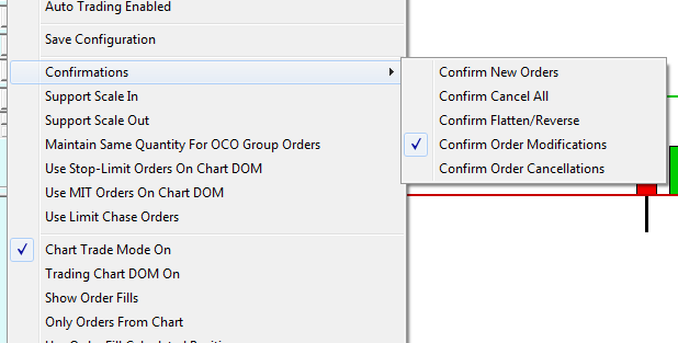

aydex - Posts: 110
having an issue keeping this setting persistent through application restarts.
It always resets to the confirm enabled setting shown
imageconfirm.png / V - Attached On 2016-03-23 19:53:09 UTC - Size: 14.01 KB - 379 views

[2016-03-24 03:16:54]
Regarding post #7 there are two possibilities.
One possibility is you are changing the Trade Window configuration and therefore changing the Order confirmation options to what were previously saved with the configuration:
http://www.sierrachart.com/index.php?page=doc/doc_TradeWindow.html#OrderConfirmations
The other possibility is that you are not saving your charts as a Chartbook. Here is the documentation for this:
http://www.sierrachart.com/index.php?page=doc/doc_Chartbooks.html
Date Time Of Last Edit: 2016-03-24 03:26:30

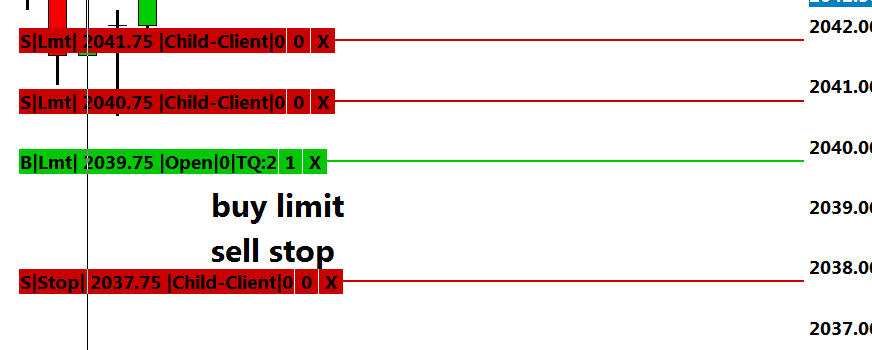

aydex - Posts: 110
So instead of all attached orders being displayed when order is placed,
the parent order only is shown, and once that is triggered, the targets and stops are then displayed as spec'd.
in the attached, the buy limit "line", or a similar indicator, would be shown until the limit order was reached
and then once reached, the target and stops are shown as well.
saw this feature in the OEC platform, and it really helped clean up the chart when in use, as can be imagined, especially when multiple orders are placed.
If not a feature, is this something that could be considered?
imagesnip.PNG / V - Attached On 2016-04-06 21:36:01 UTC - Size: 15.9 KB - 408 views
[2016-04-07 06:24:42]
On the Trade Window menu (M button) you need to enable Hide Pending Attached Orders.
Here are the instructions to open the Trade Window:
Basic Trading and the Trade Window: Opening Trade Window for Chart or Trade DOM
Date Time Of Last Edit: 2016-04-07 06:28:07
