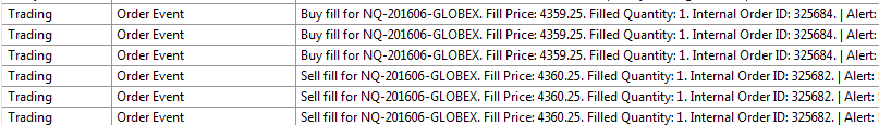

When an order is filled, for some reason three order events and alert sounds are triggered. Is there a way to prevent this so that only a single alert sound is triggered when an order is filled?

Is that possible? It's an order for a single futures contract, so it seems strange that it would fill partially three times. It's also happening exactly three times on every order.
[2016-03-15 18:57:12]
User534053 - Posts: 25
Here is a screenshot of what it looks like in the log.
image2016-03-15_1156.png / V - Attached On 2016-03-15 18:57:05 UTC - Size: 17.82 KB - 395 views

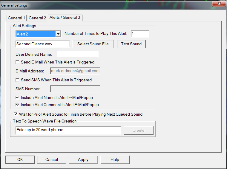

Therefore, you have set the particular Alert Number to play a sound three times. Refer to:
https://www.sierrachart.com/index.php?page=doc/doc_GeneralSettings.html#AlertSoundSettings
[2016-03-16 03:42:54]
The setting "Number of times to play this alert" is set to 1. Here is a screenshot of those settings.
image2016-03-15_2041.png / V - Attached On 2016-03-16 03:42:46 UTC - Size: 52.77 KB - 395 views

Yes, in Trade Simulation Mode it works as expected, only one alert. It looks like the bug is in Interactive Brokers or in the integration with Interactive Brokers?
