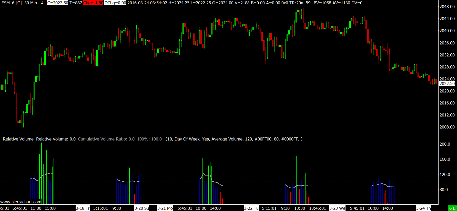

[2016-03-24 07:55:12]
We tested this and we do see the Relative Volume study appear correctly:
http://www.sierrachart.com/image.php?l=1458806100973.png
Unless we can reproduce the problem it is hard to know why you had an issue. It is not unusual to see differences if there are differences with the underlying data in in the charts it is being used on.
If you notice a difference between charts, then look at the open, high, low, close, and volume values of each bar and compare them to the bars in the other chart being compared to, to see where there are differences. Not an easy task, but if you are going to tell us there is a difference, you will need to determine what that difference is.
