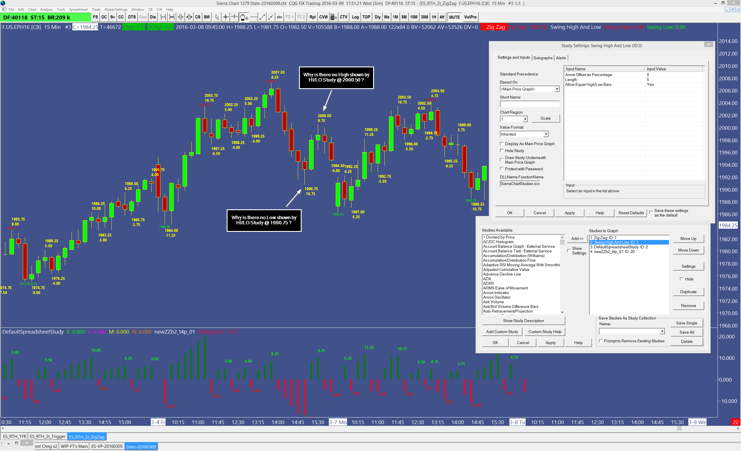

I have the SC Swing High & Low Study on my 15m ES chart. I've noticed that every now and then the study appears to miss a high and low. I have attached a screenshot of my chart and have noted where it appears that a low @ 1990.75 (March 4, 15:00 EST) and then a high @ 2000.50 (30 m later at 15:30 EST) were missed. I've added a Zig Zag study (in yellow), to highlight the high/low points. The high/low study are the very tiny red and green numbers.
Is there a reason that the Swing Hi/Lo study did not note the above high and low? Is there something I need to do to catch those in the future? As noted in the attached screenshot, my settings for the Swing Hi/Lo study are: Arrow Offset as % - 0, Length - 5, Allow Equal High/Low Bars - Yes.

User20450 - Posts: 330
u have new high and low before a 5 bar count lower swing count to 2-3 and u will see it

The Length Input is set to high. We will update the documentation to clearly explain how the Length Input is used.
