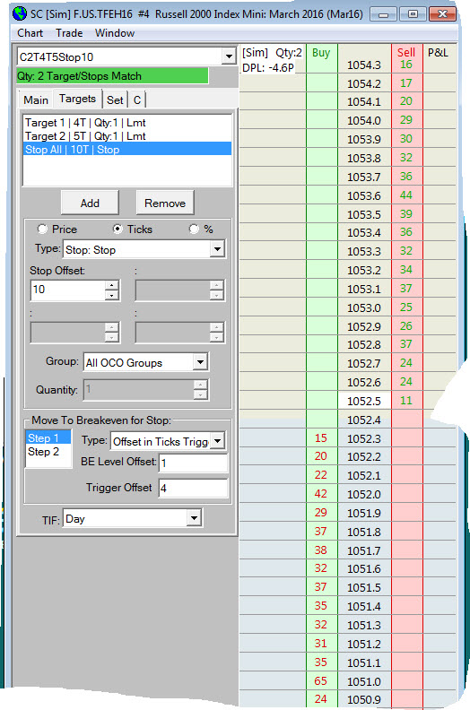

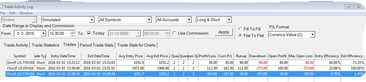

I use an OCO order where if the price moves 4 ticks in the anticipated direction of the trade, the stoploss moves from the original position to breakeven plus 1.
Sometimes the Chart DOM is not moving the Stoploss, although the price reached the 4 ticks in the anticipated direction of the trade.
The market went to 1051,3 on the TF, so the trigger should be doen to move the stoploss from Original positon to breakeven plus 1.
I was able to catch this behaviour on video - see atachement. I also include 2 screenshots showing the trade log and the settings for the OCO ordertype in the Chart DOM.
Question: Is there any explanation why this is happening? Should I change any settings in Sierra? Do you require more information from me?

[2016-03-02 23:12:29]
We tried playing the video file but Windows media player indicated had a problem playing it.
We tested your Attached Order configuration during a replay and it worked properly.
Replay the chart and test it and see if you notice the same problem. Here are the instructions:
http://www.sierrachart.com/index.php?page=doc/doc_ReplayChart.html
We also recommend using OCO Group Triggered for Move to Breakeven for Stop >> Type. It will work like you probably would expect.

[2016-03-03 14:34:00]
User295967 - Posts: 32
1. I downloaded the simo172.avi file from the forum and replayed without issues on my PC (win 7 SP1)with standard Microsoft media player. Also the Original file I uploaded when reporting the issue plays correctly with Windows Media Player. I have different PC's here and on all the file plays well back with windows media player.
2. When I try to follow your guidelines by using OCO group triggered, the Original stoploss is not moving to breakeven plus 1 - so I think using offset in ticks triggered should be used?
here OCO scenario:
2 contracts
Target 1 = 4 ticks
Target 2 = 5 ticks
Original stoploss = entry minus 10 ticks
When price moves 4 ticks in the anticipated direction of the trade, then the stoploss should move from Original position to breakeven plus 1.
