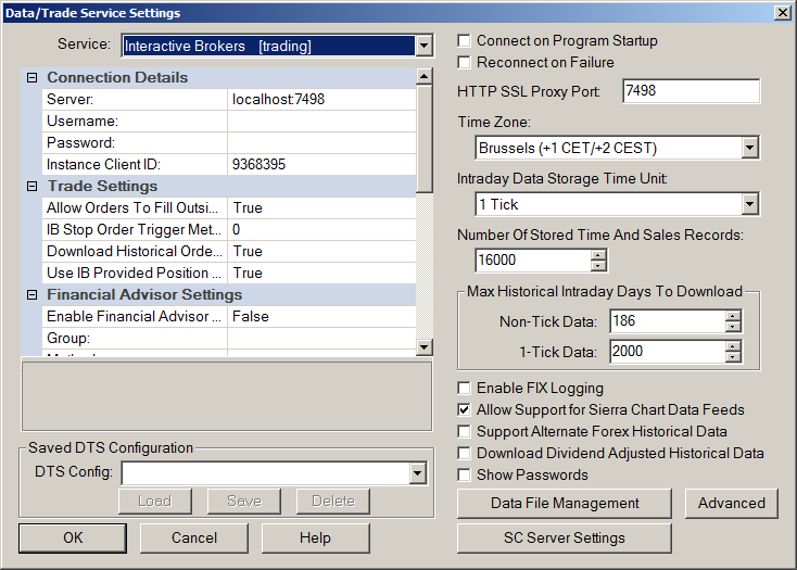

[2016-02-25 10:24:05]
wat - Posts: 67
I am using tick by tick data, set is correct, I am using "global time zone" in Chart setting and in Data trade setting i ve set Brussel +1,
is it possible there is problem ?
imagetick by tick setings.png / V - Attached On 2016-02-25 10:23:10 UTC - Size: 33.83 KB - 383 views

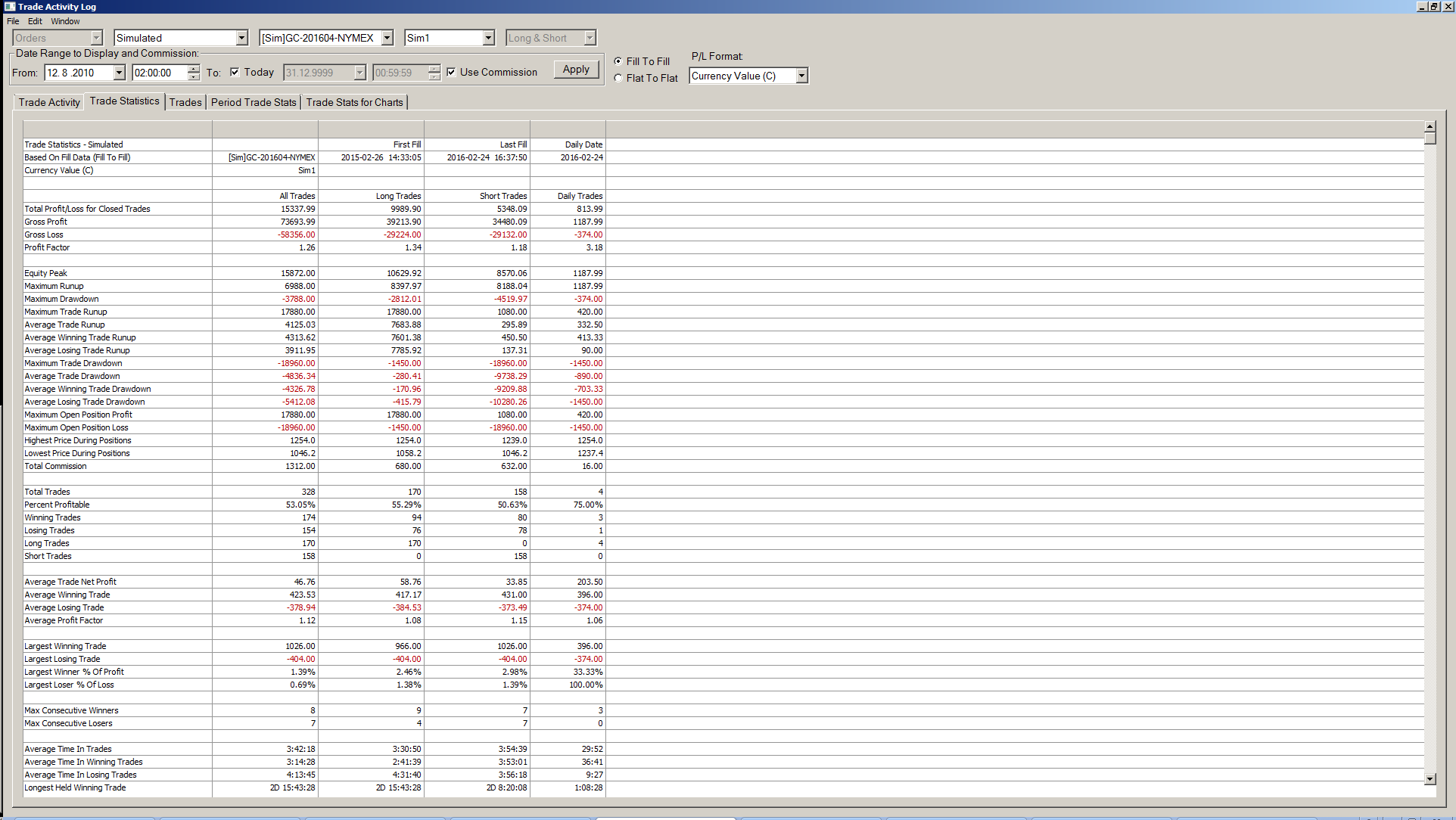

What is most frustrating, i did 328 trades in backest, i have the same take profit and stop loss (f.e: GC 40 TP, SL 40) and i ve got very often higher gains and i ve got very often lower losts, BUT never higher loss than is SL 40 ticks. Backtest helps me in huge numbers ! U can see my screenshot. What s wrong ? I have no idea ...
See, if I did 20 more winning trades than losing trades, I would expect profit of more or less 8.000(in this spesific case, not deducting comissions). Backtest however shows profit of 15.338(cimmisions deducted).
This would mean the fills were HEAVILY influenced by volatility, but I doubt this would be such a high number.
Thank you guys
Date Time Of Last Edit: 2016-02-25 14:17:54
imageTrade statistics.png / V - Attached On 2016-02-25 14:11:42 UTC - Size: 84.77 KB - 433 views
[2016-02-25 18:38:48]
We looked at the data and the problem is the Bid and Ask prices in the example you gave are out of range compared to the last trade price.
We noticed that more than once around the same time with the GC market. This is the result of the price moving fast but the exchange not updating the Bid and Ask frequently enough.
We are looking more into this and thinking about a solution.
