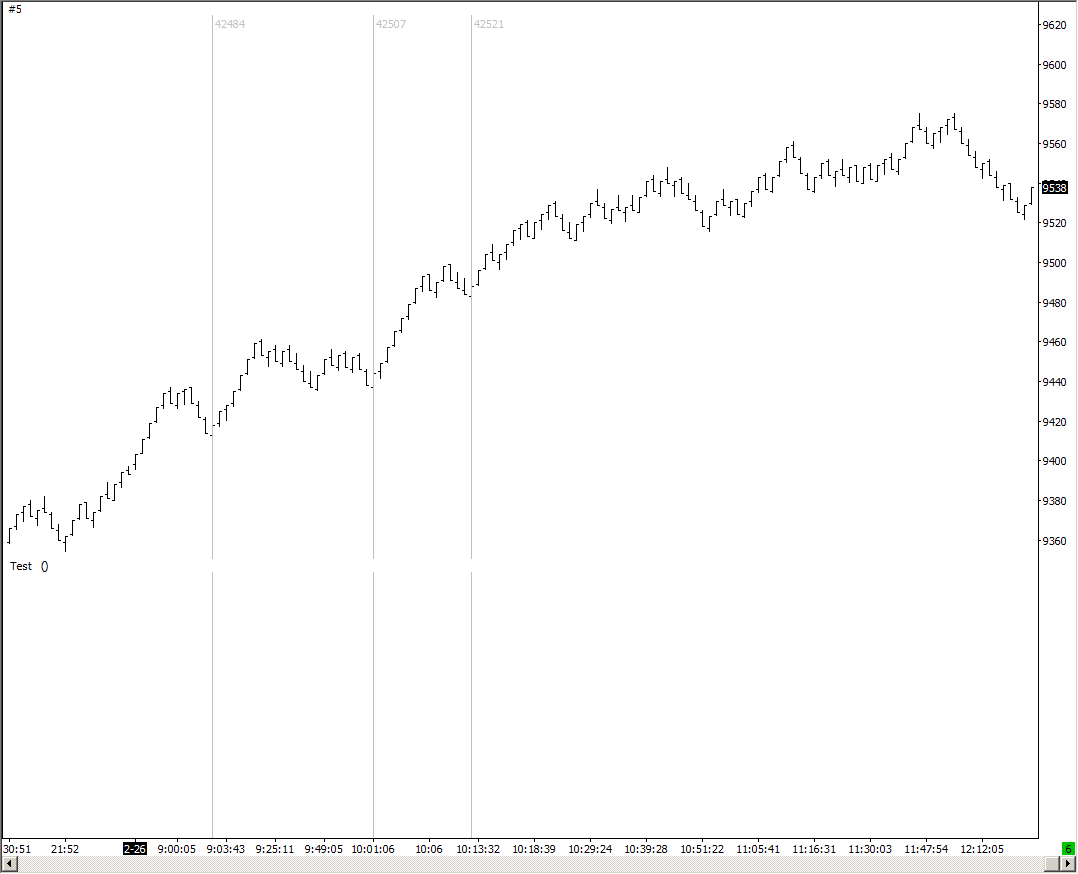

So the case is this:
1.
I draw 3 vertical lines on the chart
2.
Then I select one of them by mouse (left click) -> the small dots will appear to it to show me that I have seleceted this line.
3.
Now I will press the Custom Study Button in the Control Bar which will throw events for my Custom Study which is attached to the chart.
What this Custom Study does is that it will loop through those lines on the chart but how do I find out which one of those lines is the one I have selected by the mouse (I would like to target the actions in my custom study only for that selected one) ?
The starting situation on the chart. There is 3 vertical lines and their index can be seen from the text field

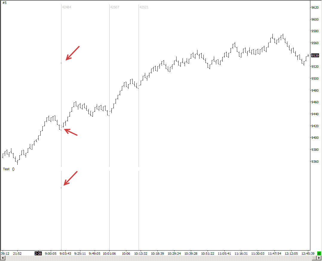

This is what happened when I did a select by the mouse (left click). The small dots are telling me the line is "selected".

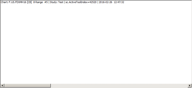

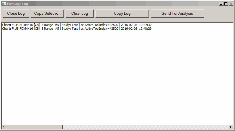

Then I pressed a user confugred button and here is what happened on the log

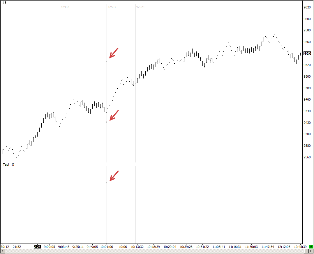

Here I tried to select another line.
Again I pressed the user button and the log was updated
So at this point we can clearly see the sc.ActiveToolIndex does not update it's value
NOW I selected the line again and moved it from it's position to the next bar and then I moved it back to it's original position and then I pressed the user button again and here you can see the log is telling us now sc.ActiveToolIndex is updated correctly.
