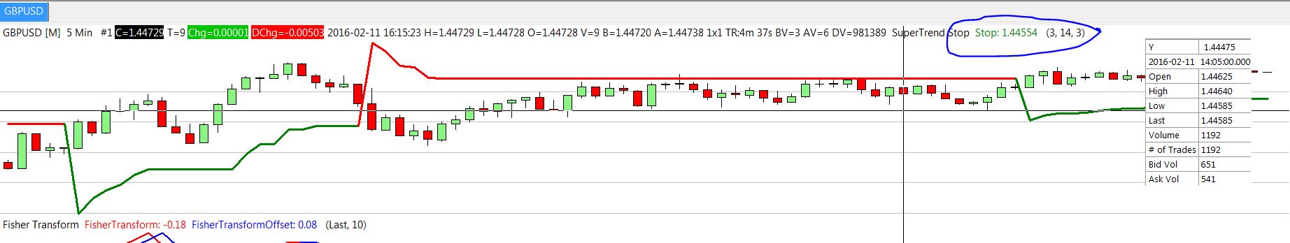

And also regarding using the crosshair to see the values of a study on historical bars on a chart, the documentation that you suggested to me does NOT address this issue. I AM using the crosshair and like I said, when I move across the bars, all I see showing in the 'Values" window is the historical price information. Attached please see the screenshot. What I want to see is the historical value of the "Stop" from the custom study "Supertrend Stop", circled in blue on the screenshot. You can see I am using the crosshair but my crosshair is clearly at a bar where the "Stop" is supposed to in red color and is of a different value from what shows up on the chart which is in green. And the correct "Stop" value does NOT show up in the "Values" window on the side either.
This is what I meant. You no longer wish to help me that's fine but you did not understand my question and your provided documentation did NOT really address the issue.

You need to use the Window >> Tool Values Window.
This is what the documentation says but possibly the browser did not scroll to the proper location. The documentation also explains that you need to select Window >> Reset Windows if you do not see that window. And to reselect that command after.
There is also a screenshot of it.
We will still help with critical issues or simple questions. And understood what is said in post #6. When we said, we do not want to provide any further information, it is not due to the account status but because the documentation is very clear and we do not want to restate it. But possibly like we said maybe the browser did not scroll to the right location.
