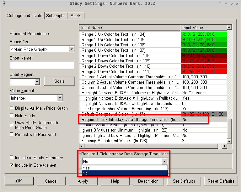

ticinotrader - Posts: 431
There is a setting in the Numbers Bars study (ln 118): 'Require 1 Tick Intraday Data Storage Time Unit'.
Setting this to 'No' will not trigger the 1 tick unit in the Data Trade Service settings.
After making this adjustment (then setting the Data/Trade Service Settings properly), you may need to close SC, delete the .scid files then re-download them after restarting SC.
I am posting, just in case if someone finds this helpful - although this has not been an issue until now (January 2021), somehow in newer versions this triggered occasionally (Numbers bars setting reverted back to 1 Tick Storage = Yes)

[2021-02-01 04:17:39]
This definitely cannot be the case. There is another explanation for this. Possibly you have a Study Collection saved with Numbers Bars or a Chartbook that has this Input set to yes.
