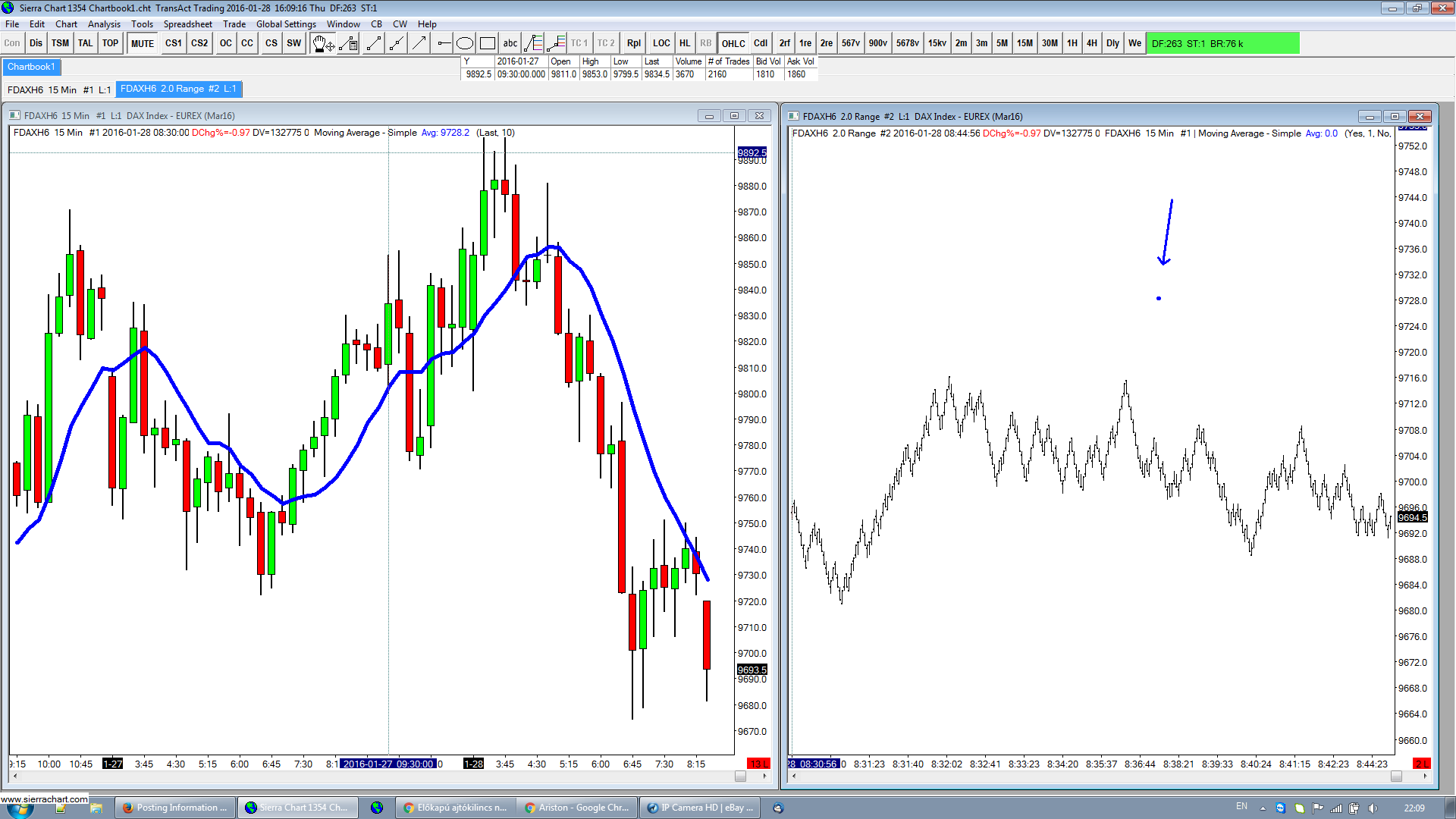

When I project
- a moving average from
- 15M to a small (4..8) range bar chart and
- set Fill Blanks With Last Value to No and
- choose Draw Style as Line
then only a dot is shown at the very end of the small range bar chart if the market has been active and moved that much that the last-1 15M MA point went out of the window of the range chart. In this case no MA line is drawn on the range chart.
Would it be possible to draw the projected indicator's line from the last pont back to the last-1 even if the latter (or both in case of scrolling back) is out of the pane?
Thank you

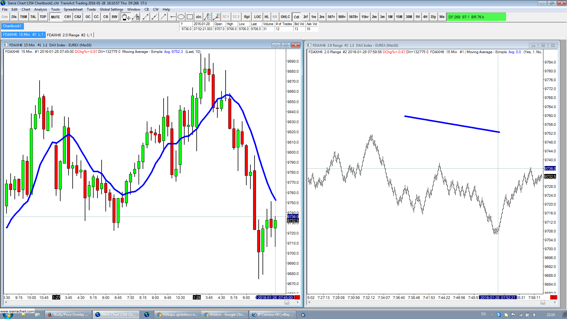

cross - Posts: 70
Single dot
http://www.sierrachart.com/image.php?l=1454015358476.png
Partial line
http://www.sierrachart.com/image.php?l=1454015460764.png
Charts are linked for scroll position.
[2016-01-30 03:51:49]
We looked into this. You must use Fill Blanks with Last Value. There is no other possibility and we will not be making any changes.
