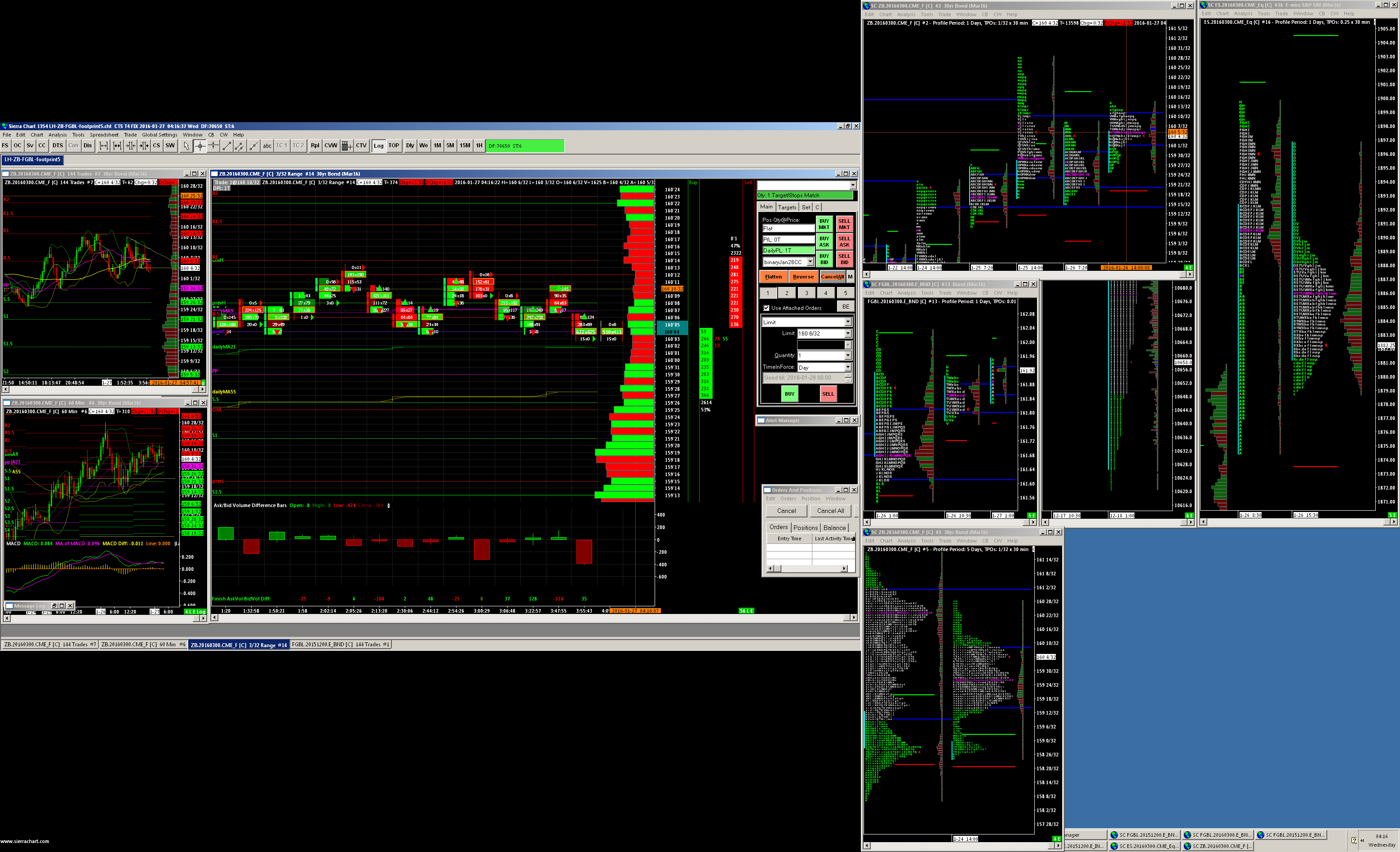

I'm confused by the attached ChartDOM vs numbers bars and would appreciate your interpretation. Here's the screen shot that applies:
http://www.sierrachart.com/image.php?l=1453889801958.png
Please note the area around 160'02
The numbers bar at 160'03 says 15 lots traded at the bid and none at the ask. If I look at the ChartDOM, I see 13 at the bid of 160'02 (that's what made me take the screen dump - the increase from 2x to 15x) but no numbers bar print at '02.
Should I interpret this that the 13x printed at '03 when '03 was the bid, or is the numbers bar incorrect and the numbers bar should actually appear at '02?
I have the numbers bars configured for Bid Vol x Ask Vol with colouring based on the diagonal dominant side.
Lee.

[2016-01-27 10:43:41]
binaryduke - Posts: 387
Thank you for the quick response. I'm familiar with the documentation.
The ChartDOM is showing:
price / buy order column / bid size / RECENT BID VOLUME / RECENT ASK VOLUME / ask size / sell order column
I am only referring to the window containing the chart DOM.
HERE IS MY HOPEFULLY CLEAR QUESTION
Please can you explain how RECENT BID VOLUME can show 13 contracts hitting the bid at 160'02 when there is no corresponding numbers bar at 160'02 but the volume appears to be shown on the 160'03 numbers bar.
If you would be kind enough to explain that, I would be most grateful. Thank you.

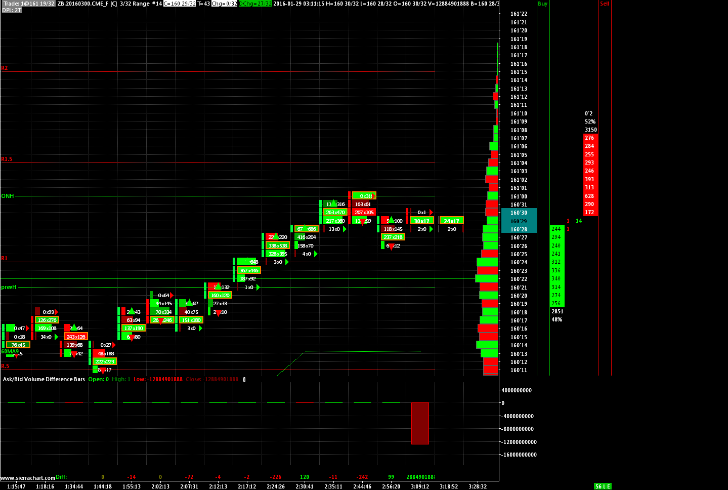

[2016-01-29 09:13:25]
Hi
It looks like this prerelease now has a problem for volume calculations per the attached screen dump showing Finish AskVol BidVol Diff and Ask/Bid Volume Difference Bars:
http://www.sierrachart.com/image.php?l=145405868071.png
Regards
Lee.
[2016-01-29 09:17:50]
We will look into this now. This might have something to do with the new CME trade unbundling feature that CTS released for FIX because otherwise we see no reason why there would be a problem.
[2016-01-29 09:24:35]
I just deleted and redownloaded the symbol data within the pre-release and now the volume appears OK. I guess your internal storage method for the volume data changed.
[2016-01-29 09:32:16]
We have spotted the problem. CTS is transmitting sometimes -1 for a trade volume.
So that needs to be filtered out.
Give us about an hour.

[2016-01-29 10:48:31]
This is now solved. Update to the latest prerelease again using Help >> Download Prerelease.
