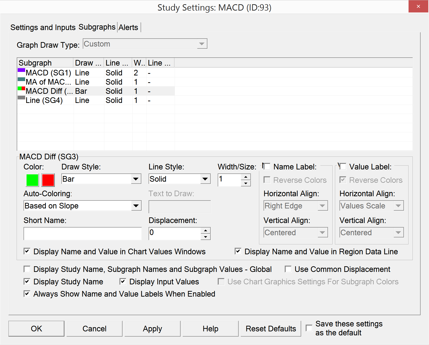

[2016-01-27 20:15:37]
User380760 - Posts: 88
use auto-coloring, select "based on slope", or "based on angle gradient".
Date Time Of Last Edit: 2016-01-27 20:17:47
image2016-01-27_15-16-48.png / V - Attached On 2016-01-27 20:17:43 UTC - Size: 97.47 KB - 756 views

[2016-01-28 22:17:59]
User550516 - Posts: 9
I adjusted color bar to slope but it appears to still be referencing off of price bar. Any other suggestions.
[2016-01-29 00:12:57]
Sawtooth - Posts: 4358
Remove all three Color Bar studies.
Then, in the MACD study, set the Auto-coloring of the MACD Diff to 'Based on Slope'.
There should be no formulas in the Alerts tab of the MACD study.
[2016-01-29 00:37:39]
Thanks so much for your patience. That did it, exactly what I was wanting.
