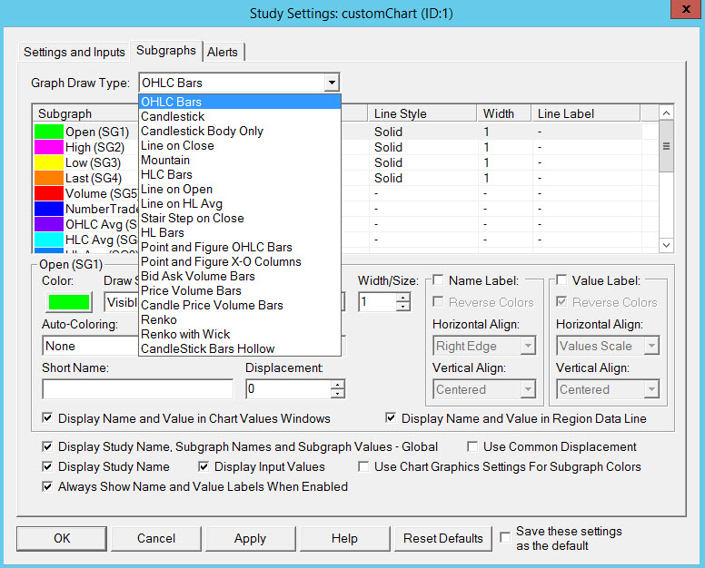

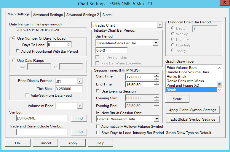

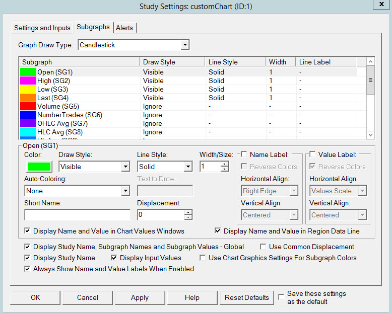

SC Team - At present I can select "blank" for graph draw type.
On the same note - I am trying to create a custom chart - but there is no "blank" type available for Graph Draw Type ( sc.GraphDrawType ). Would it be possible to add a "blank" type as one of the available values?
With the current mode - though I try to "force" ignore for subgraphs - they gets restored back depending on the graph Draw Type. I am unable to select "ignore" for ALL sub-graphs and is the reason for this request.
thanks

[2016-01-22 20:25:57]
ejtrader - Posts: 689
I could get this taken care by simply commenting this line in the code and it gave me required result. though wish there was a blank graph draw type available, I have a work around now.
//sc.GraphDrawType = GDT_OHLCBAR;

[2016-01-25 00:29:28]
SC Team - Thanks for introducing the blank graph draw type.
There is a small bug introduced with this type - Once you select blank type (from drop down menu of study settings & apply) - you can't go back to anything else ( all the options would be blank). This is NOT a show stopper for me but thought of mentioning if this was something that was NOT intended to be.
Date Time Of Last Edit: 2016-01-25 00:29:43
[2016-01-25 01:08:59]
Yes, this is true. We will patch that now.
