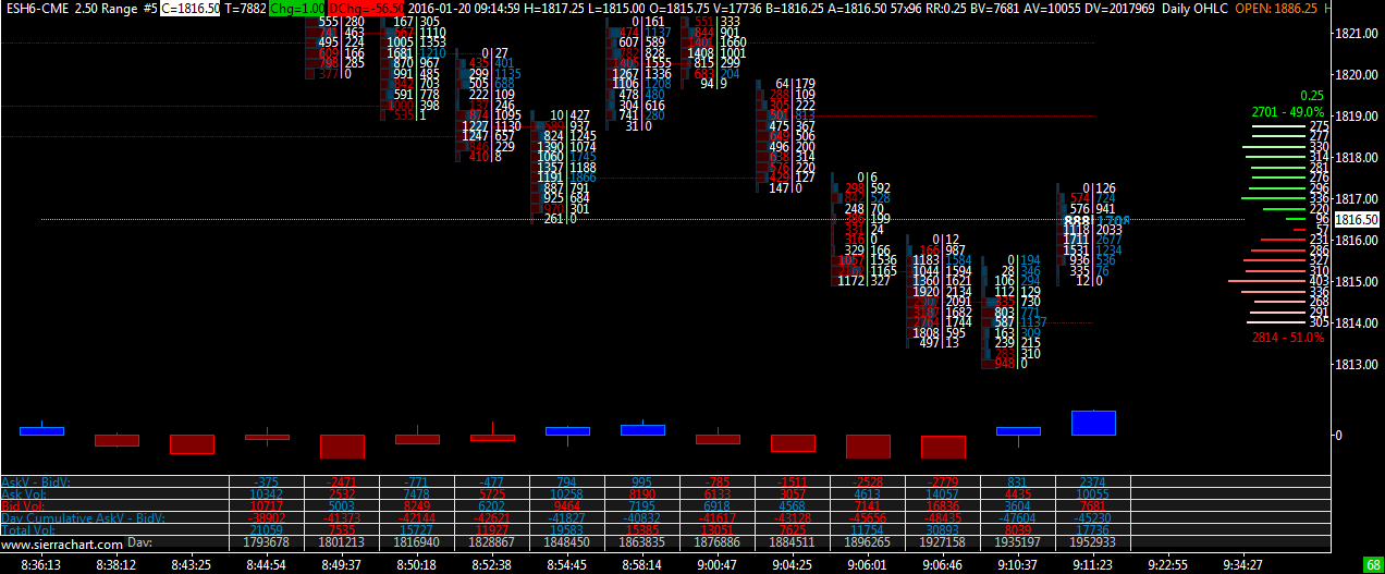

Would like to revisit this issue with the current price line halving the numbers in the current numberbar. 888/1708 in the most current number bar gets distorted. you can't read it. The only way i can read it is by zooming in or scaling in more but I would like to read it more zoomed/scaled out. Without the current price line, i can read it just fine.Last time we spoke i put current price line at the top of the studies and it did nothing. Is this a bug?

I followed your instructions and it did not fix the problem. I've attached an image showing the solution you gave me and the problem red circled still happening.

The problem is the Column 1 Background Coloring Method for the Numbers Bars study in your case is set to Transparent.
There are also various Inputs with the Current Price Line study to change how it is displayed. Refer to:
https://www.sierrachart.com/index.php?page=doc/doc_TechnicalStudiesReference.html#s123

Appreciate the help. I figured out the problem. I had to increase scale range. When current price line goes through the most recent numberbar, it enlarges the text of the numbers for bid/ask. With a smaller scale range, the numbers look cut off as it can't fit inside the smaller scaled bid/ask numberbar.
