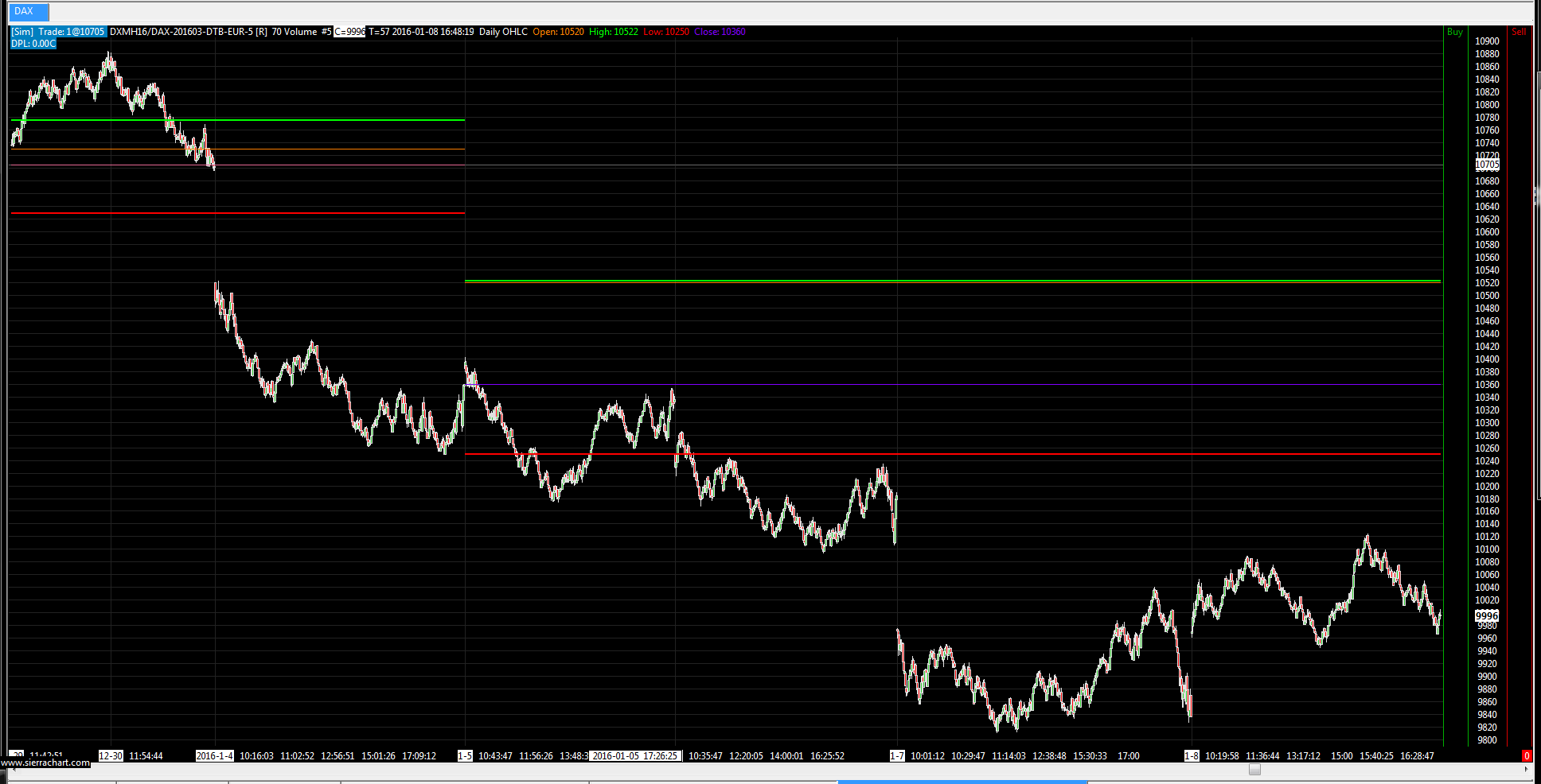

I am having a problem with the Daily OHLC study. It track a bunch of days in row instead of one day at a time and that started since december. I am attaching an image, everything is set as default in the study.
http://www.sierrachart.com/image.php?l=1452503951159.png

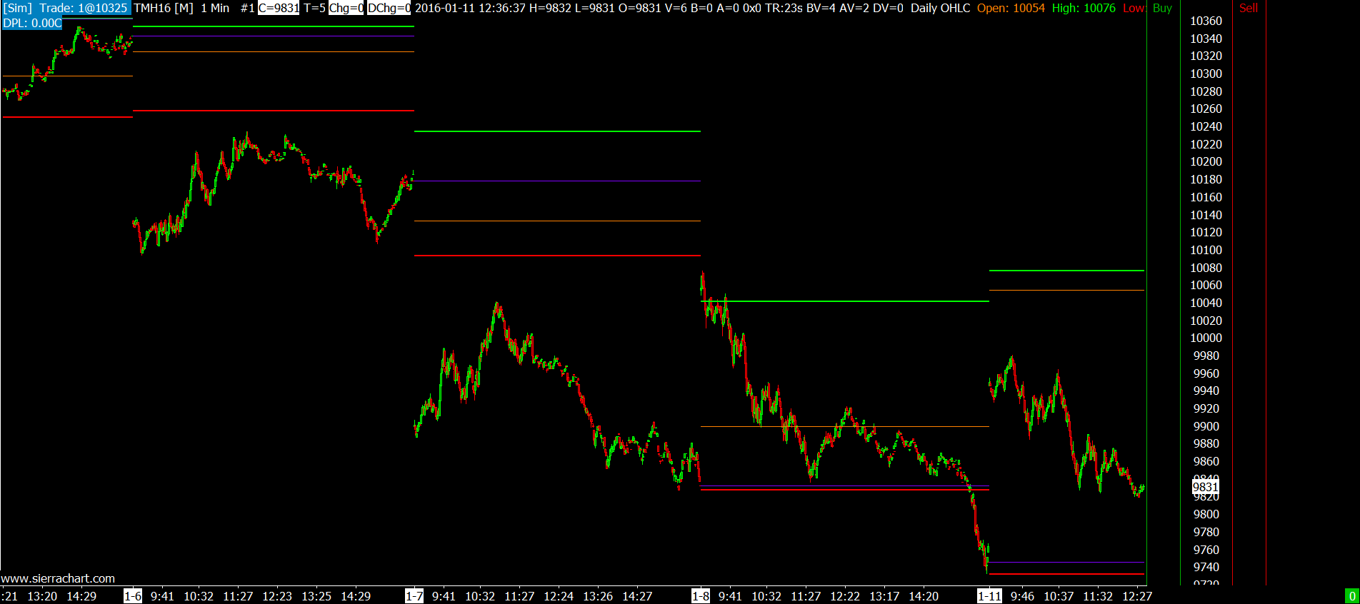

After correcting the symbol and setting the chart to 1 minute per bar, this is what we get:
http://www.sierrachart.com/image.php?l=1452534460694.png

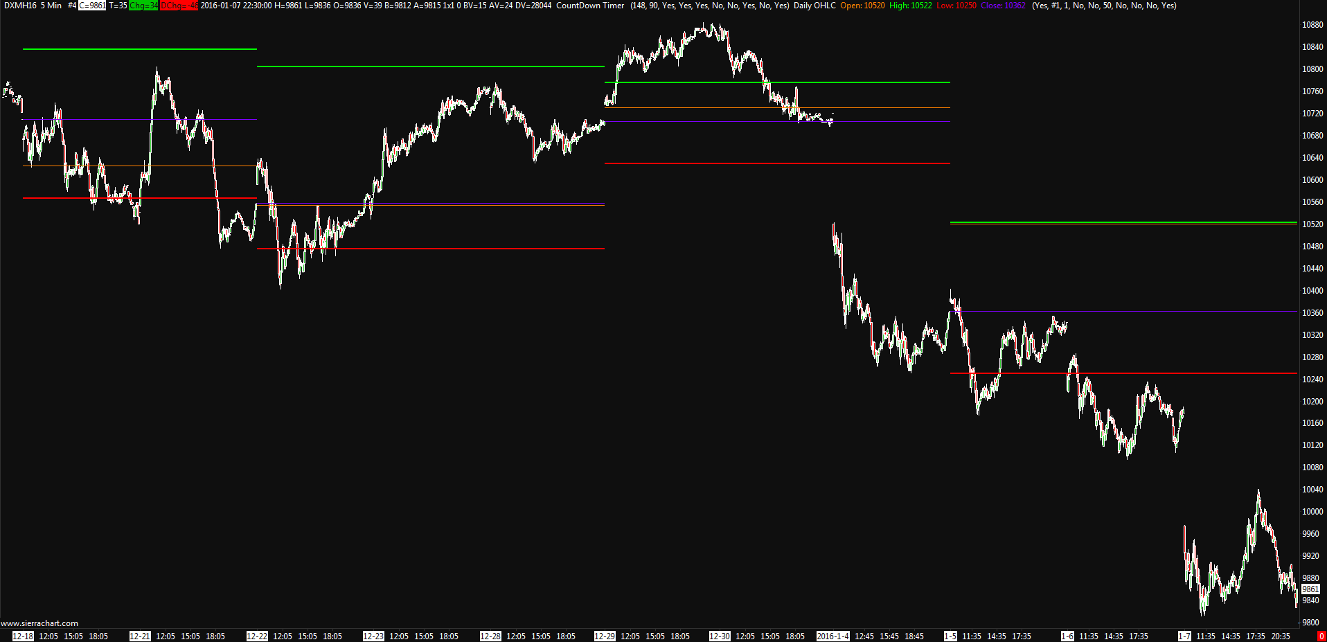

I did what you suggest, and nothing changed, I even deleted all files .scid and .dly of that symbol from both instances of sierra(IQFee/IB) and redownloaded, once I open the same thing. I deleted again all files from data folder and opened Sierra with IqFeed and created a new chartbook and this is what I get
http://www.sierrachart.com/image.php?l=1452536607685.png
