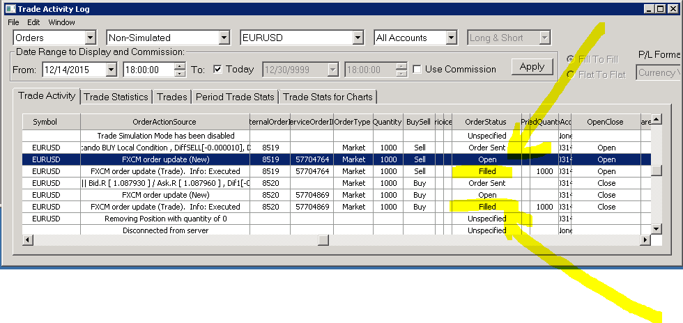

Hello.
With new addition of record milliseconds on activity log its now fantastic because I can debug full my system. ( Pair Trading HFT ).
Please check my image, the resume its:
1.- From my acsil code I recorded time when I sent order and when ( result > 0 ) its performed, I supposed ( as your support info example ) that this way its the correct for correct flow of sent orders and wait for fill.
In my example, see picture please, all above steps ( via acsil ) start at 01.580 ms and end at 01.580 ms too !.. I noted this strange due I am 20 ms away from fxcm server and 8 ms away to ds5.sierracharts server.
2.- In Trading Activity Log I see "detailed" times too and dont match:
* Started at 01.580 too,
* But end at 01.819 ! .
I assume that times recorded in TAlog are "real", so the question its: How can I know/read/flag within acsil code until the trade was really accepted by FXCM ?
Hope be clear.
Thanks in advance.

[2016-01-08 18:35:42]
The first line in the Trade Activity Log for an order submitted from Sierra Chart, is immediately added at the time the order is submitted.
So in your case, that particular order was accepted at
01.655 (seconds.milliseconds)
[2016-01-08 18:46:54]
User368248 - Posts: 46
Thanks for reply but:
This question its due ( result > 0 ) was not real.
Also I check with FXCM log fix details and they sent me all flow of order.
Thanks in advance

[2016-01-08 18:50:25]
There is not a reliable way when using ACSIL to get the exact time that the order was accepted.

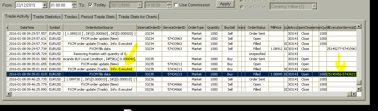

Well, I think its possible get this:
a) Waiting for "Executed" word in OrderActionSource column
or
b) Waiting for number on FillExecutionServiceID.
How can I access to this info via acsil?
If not its possible then I have a problem because I need to control the real flow open/close of trades.
Thanks in advance.
Please refer to attached image.
imagefxcm_times_2.PNG / V - Attached On 2016-01-08 19:17:50 UTC - Size: 42.03 KB - 427 views
[2016-01-10 07:52:59]
It is possible to access historical order fills. Here is the documentation for that:
http://www.sierrachart.com/index.php?page=doc/doc_ACSILTrading.html#scGetOrderFillEntry
