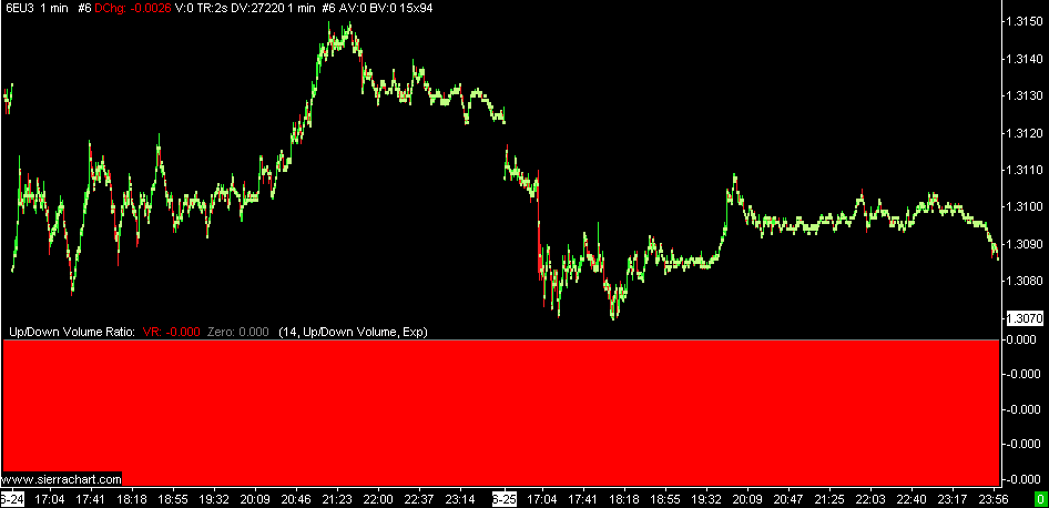

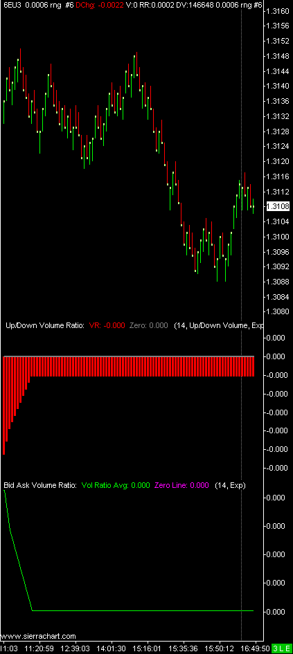

I get defective data in 6EU3 range chart, Up/Down Volume ratio study.
My data feed is OEC.

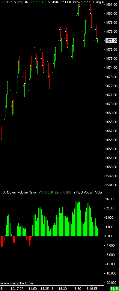

ESU3 range chart shows good data by the same study when applied.
I'm on ver 991.
I didn't have this problem in the past, about 2 month ago..
Examples attached.
6EU3 example of Up/Down Volume ratio study with defective data:

ESU3 example of good Up/Down Volume ratio study data
http://www.sierrachart.com/image.php?l=1372168369919.png

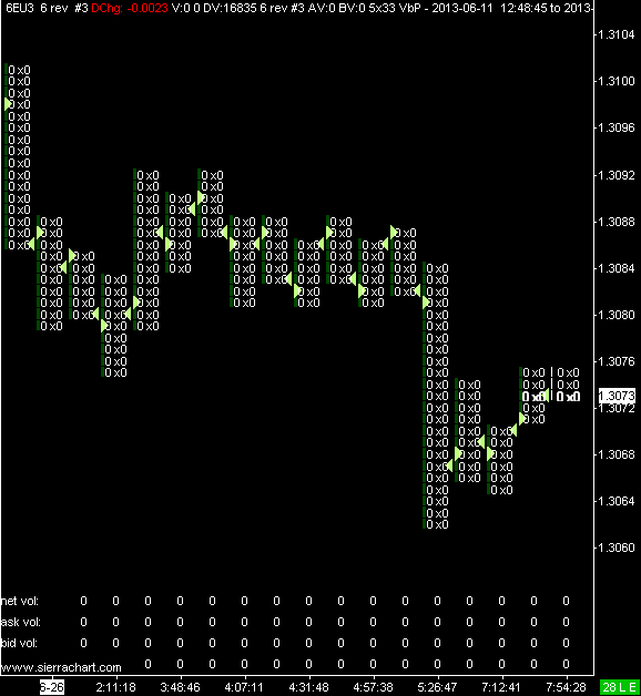

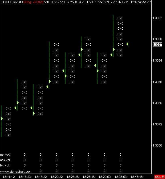

Please look also into the following link of 6EU3 6 tick reversal chart which shows "zeros" - no data !!!
I believe that the problems are related..
http://www.sierrachart.com/image.php?l=1372222895377.png

[2013-06-26 06:34:57]
The Message Log looks fine. We did a test and we do not see a problem with this study:
http://www.sierrachart.com/image.php?l=1372228435288.png
Not sure why this would matter but try removing the study from the chart and adding it again. Also try opening a new chart window. Do a test on a normal 1 minute chart.

avifutures - Posts: 59
Removing the study and adding it again was done several times in the past with no success. Done again now, with no success..
Opened a normal new 1 min. chart (Link to its snapshot attached) showing the porblem persist..
Verified that no volume filtering have been set up.
I am afraid that this might be the result of bad 6EU3 data feed from OEC. Can you do repeat the checking you have done but with OEC data feed ?
Examples of both (related ?) problems:
http://www.sierrachart.com/image.php?l=1372229745144.png
http://www.sierrachart.com/image.php?l=13722297731000.png

You have changed the Volume multiplier for these charts. This is causing a problem.
[2013-06-26 11:07:05]
What should be the valid volume multiplier ?
[2013-06-26 11:09:30]
What does common sense tell you it should be? Open a new chart and see what the multiplier is and you will see what the standard multiplier is.
[2013-06-26 11:10:15]
OK changed to 1 and it is OK.
