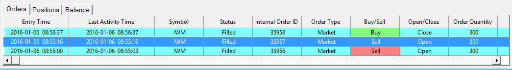

I have a spreadsheet which placed a trade twice within the one five minute bar.

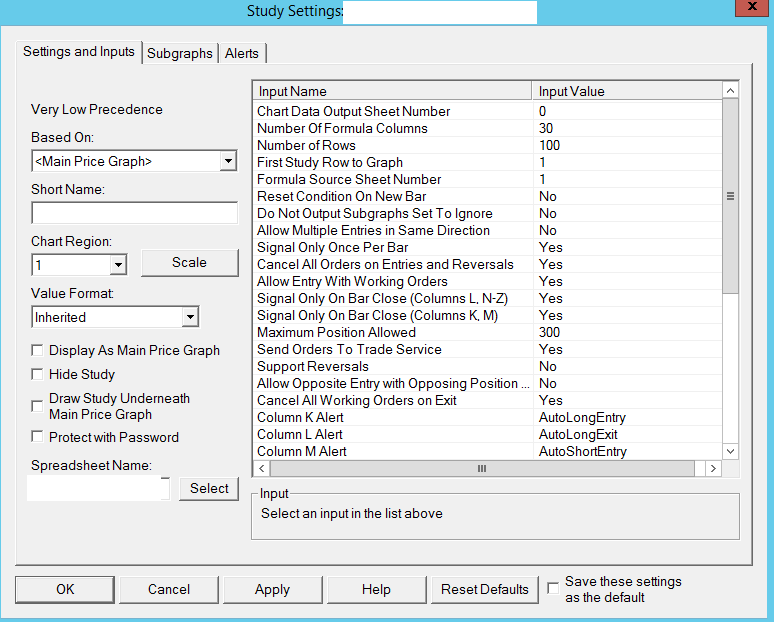

I have these settings in particular:
- Signal only on bar close - Yes
- Allow Multiple entries in the same direction - no
- maximum position allowed - 300
However, as can be seen from the attached screenshots, the spreadsheet placed 2 300 unit trades. 300 sell at 8:55:03 and 300 sell at 8:55:16 for a total of 600 units. This broke all 3 rules mentioned above, and I believe it might be a glitch of some sort. I have never had this error before. This could be quite a bad glitch, as it doubled my exposure.
The subsequent buy was a manual trade entered to reduce my exposure back to down to 300.
I am using IB, please advise if you need additional screenshots or logs.
Cheers
imageTrade Log.PNG / V - Attached On 2016-01-06 15:12:49 UTC - Size: 11.8 KB - 422 views
imagespreadsheet settings.PNG / V - Attached On 2016-01-06 15:21:35 UTC - Size: 52.7 KB - 452 views
[2016-01-06 19:33:18]
Maximum Position Allowed cannot always limit the Position quantity as explained here:
Automated Trading Management: MaximumPositionAllowed
What do you think the problem was? You developed the trading system and it is your responsibility to do your best to isolate the source the problem to the extent that you can and then we will look at the rest of it.
From our perspective, we have little idea about this. We might have some clue by looking at the Trade Activity Log. Provide us the relevant order lines. Here are instructions:
Trade Activity Log: Providing Trade Activity Log Data Lines to Support
You might also want to set this to No:
Allow Entry with Working Orders
Another thing that helps us is to know what chart bar the order signals were generated from and that information is not currently logged in the Trade Activity Log but we are working on adding that now.

[2016-01-06 19:47:07]
You will also want to set this to No:
Cancel All Orders on Entries and Reversals
And this:
[2016-01-06 20:01:44]
The only setting which should actually limit this based upon the other settings would be Signal Only Once Per Bar.
So what we are wondering is whether these orders originated from the same bar definitively. So I think we have narrowed it down to that.
The other settings are not going to place a limit contrary to what you think because of how you had these set:
Cancel All Orders on Entries and Reversals = Yes
Allow Entry with Working Orders = Yes
This brings up a question though as to whether we should still consider working market orders in the calculations even though they are attempted to be canceled. That would be the one thing we could change which would prevent this kind of problem regardless of the settings you are using.
Date Time Of Last Edit: 2016-01-06 20:05:14

I've never hard this problem before, either in real trading or tick based back testing. I am not sure how it can be replicated, to be honest and it might be a one off glitch. I don't think it is a programming error, here would be no reason for it to do that in the logic.
The signal was given at 8:50 and once the 8:50 5 minute bar was completed, the system then proceeded to place a market order as expected (except it placed two).

[2016-01-06 20:42:37]
PeakGrowth - Posts: 3
Those two settings I left them as yes as I can have this system set up to place limit orders, which I most likely might be re-enabling again tomorrow.
I am not sure why canceling working orders would affect it though? The original market order was executed 13 seconds earlier, which made it extremely odd.
I might add that I changed it to "signal only once per bar" only after this glitch happened, as I thought that this switch only affected opposing signals (e.g. a buy and sell signal both triggering). I switched it on straight away before I re-enabled auto trading in case the system started to sell 300 every 10 seconds which would have being an issue.

[2016-01-07 04:29:07]
We have enough information now. "signal only once per bar" will have prevented this.
None of this is an issue:
I only have the one system running for this one instrument, there are no other spreadsheets which are functioning except for a daily bars one which is on a different instrument and different chart book, so I don't think there was any sort of clash in terms of multiple signals.
We could spend further time examining this, but we are fairly confident now what generally has gone wrong here.
We need to consider working market orders in calculations involving working orders even with the auto trade variables that cancel orders being set to TRUE. We should have the changes in place by next week.
