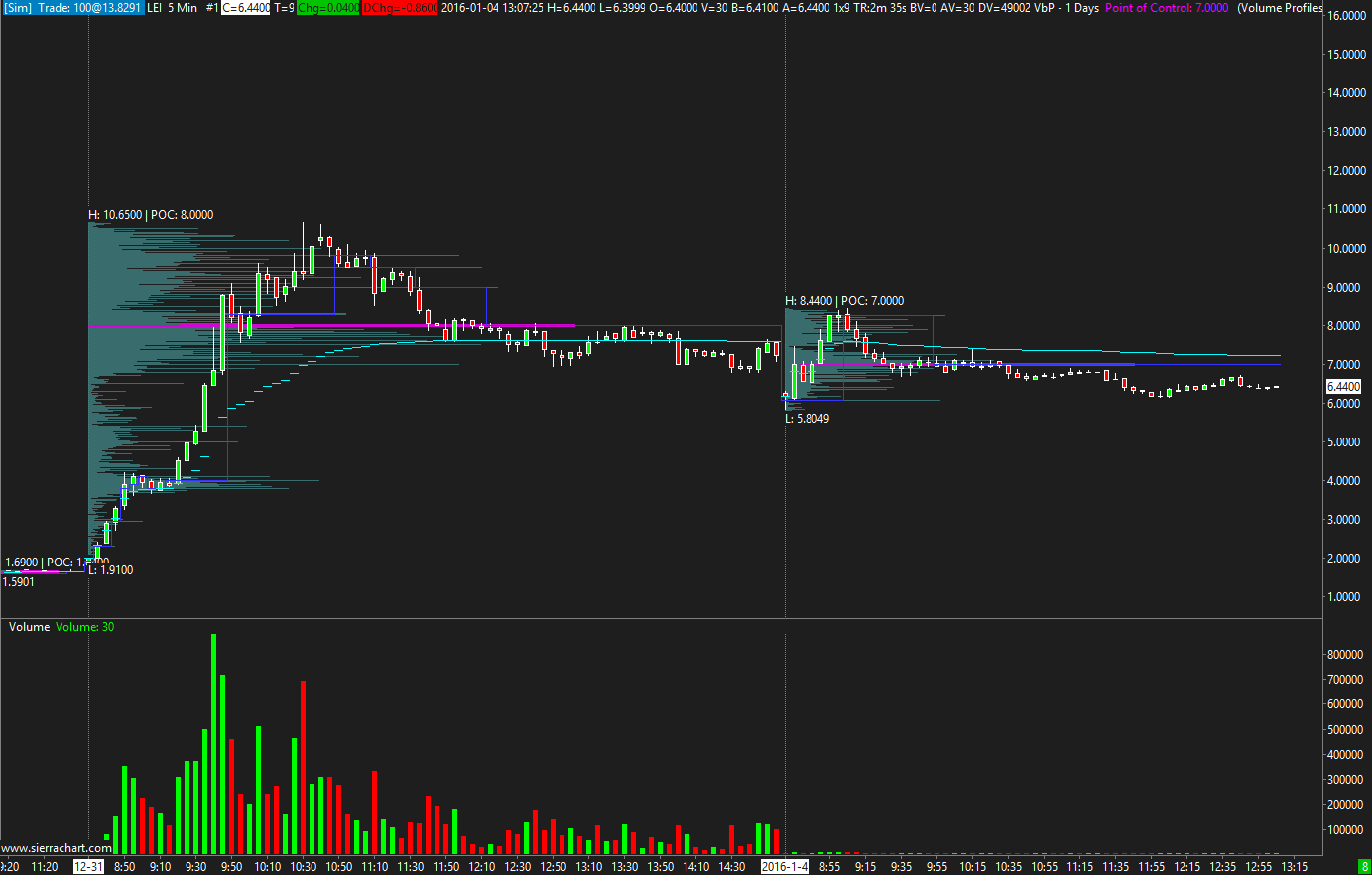

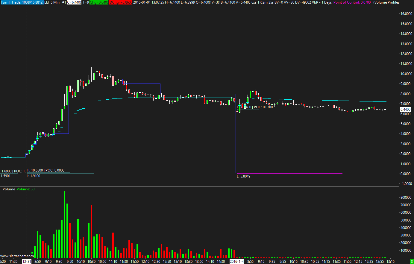

[2016-01-04 19:10:24]
Stephan908 - Posts: 46
Thank you for the reply. Here's the screenshot of the issue.
http://www.sierrachart.com/image.php?l=1451934488534.png
If I change the bar period, it will fix it -
http://www.sierrachart.com/image.php?l=1451934546564.png
