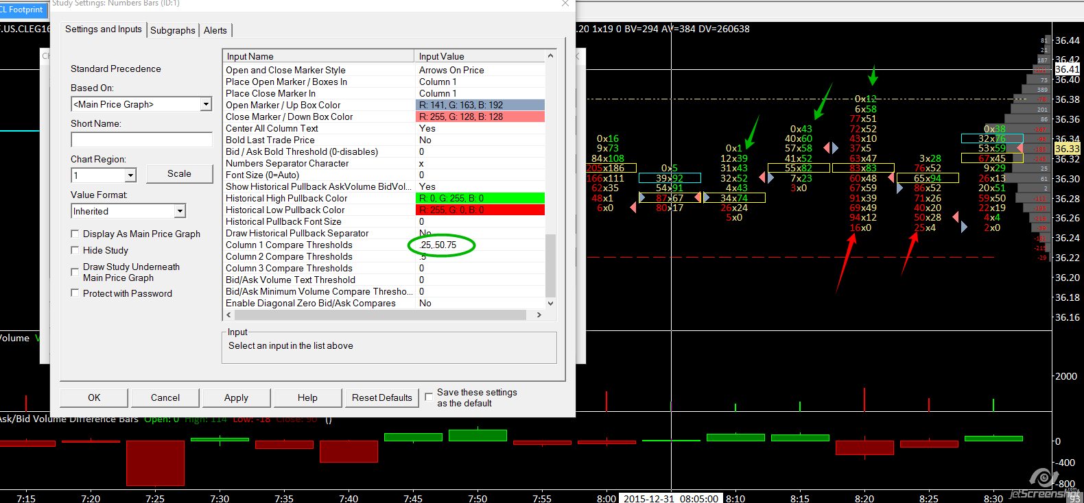

hey im trying to set a threshold on the number bars using color text on dominant side but no matter what i set the threshold too it just colors the higher number side one color and lower side another .
i want to set it to see large imbalances like 100 x 25 ( example ) but this is coloring all of them
i also tried to to use diagonal coloring but the thresholds dont seem to work either ,
i have read the documentation a bunch of times so please help me out , thanks
image2016-01-01_03-52_Study Settings- Numbers Bars.jpg / V - Attached On 2016-01-01 08:52:01 UTC - Size: 216.5 KB - 444 views

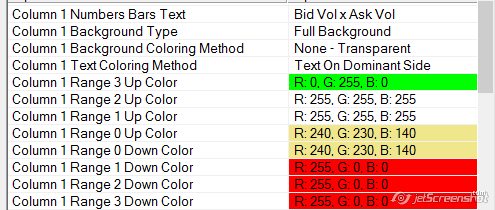

here are column 1 settings i have from pic above
image2016-01-01_03-54_Study Settings- Numbers Bars.jpg / V - Attached On 2016-01-01 08:54:02 UTC - Size: 45.68 KB - 424 views
[2016-01-01 11:15:09]
In your example you are looking for a 400% comparison . Therefore, set the Column 1 Compare Thresholds to 400, 400, 400.
[2016-01-01 17:36:22]
User20450 - Posts: 330
oh ok thank you , i was calculating that wrong , do u guys have any plans to implement options to highlight larger numbers or imbalances with horizontal line plotting so we can be aware of these levels on pullbacks or revisits ?
