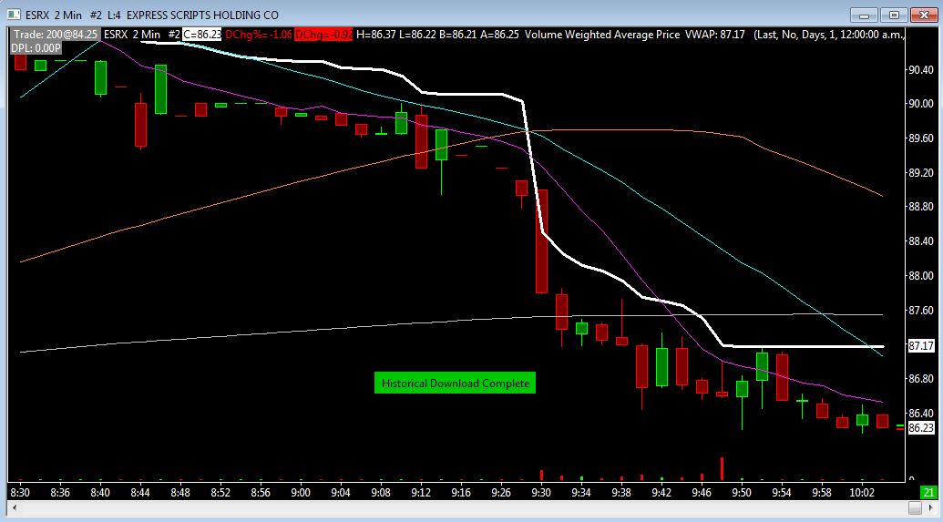

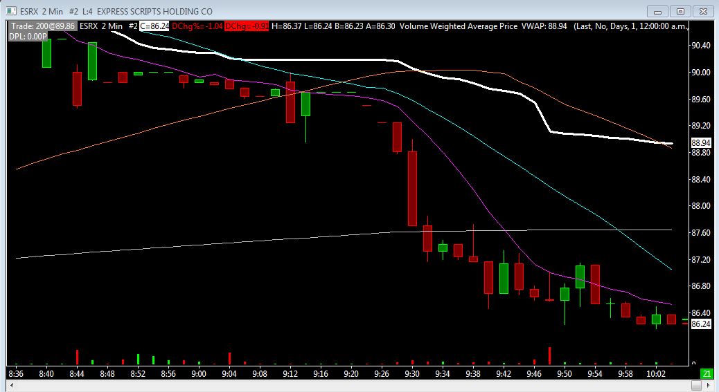

Hello. I am getting wrong VWAP calculations all the time. My quotes come from Interactive Brokers. When I right click and "Delete all data and download", it does goes through that process and corrects the VWAP.
The problem is that I can't do that every single time, so I just can't trust VWAP any more. Wrong VWAP has already lead me to many bad trades that I wouldn't have taken with the correct information.
Is there any fix to this?
Here is an example where the difference is small:
Before downloading data again: http://prntscr.com/9gtwhg
After downloading data again: http://prntscr.com/9gtwt5

[2015-12-22 13:24:29]
FedeM - Posts: 13
I get the quotes correctly, but VWAP is not calculated automatically after every candle.
Sometime I just get a straight line and VWAP remains the same value, while quote and volume data keeps coming in. When I "delete all data and download", I get the same quotes I had before, but the VWAP recalculates and fixes the curve.
[2015-12-22 15:08:12]
FedeM - Posts: 13
More examples from today.
imageesrx before.JPG / V - Attached On 2015-12-22 15:07:48 UTC - Size: 81.08 KB - 542 views
imageesrx after.JPG / V - Attached On 2015-12-22 15:07:59 UTC - Size: 83.78 KB - 555 views

[2015-12-22 18:15:33]
FedeM - Posts: 13
I just used the Chart>>Recalculate (reload and recalculate) with ESRX, it didn't fix the VWAP.
When I deleted+downloaded data, it got fixed.
ESRX 2 Min #2 | Reloading chart. | 2015-12-22 13:13:07
