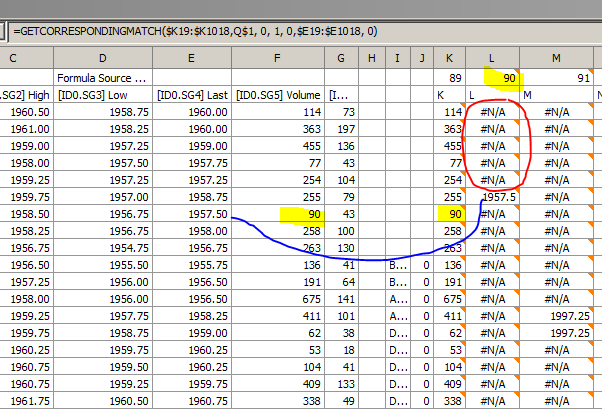

Also, in the problem highlighted here:
https://www.sierrachart.com/Download.php?Folder=SupportBoard&download=6793
The problem is the SearchRangeOrderingFlag parameter is indicating that the column is ascending when it is unordered. So it needs to be 0.
