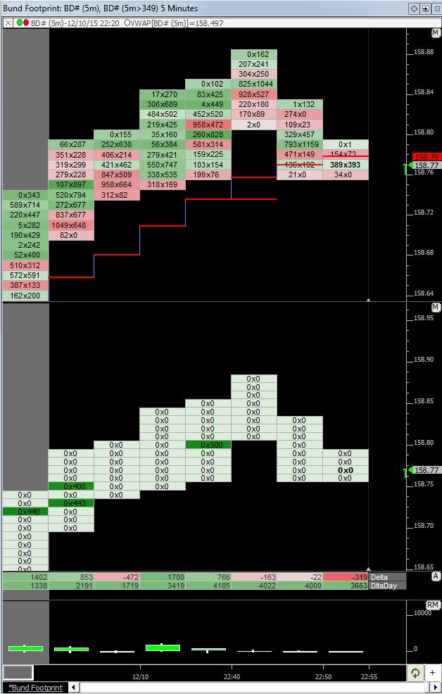

Im finding it very hard to create a number bars template even after following the instructions. Can someone please create a template that matches the example i have attached ? This is from Market Delta's Footprint charts. Would be appreciated if someone could also get the institutional number bars working too for contracts greater than 349 on Bunds.

The Column 1 Numbers Bars Text Input needs to be set to Bid Volume x Ask Volume.
You will need to add the Numbers Bars Calculated Values study to the chart:
Numbers Bars: Displaying Numeric Information Below Numbers Bars
We also see another set of Numbers Bars with different filtering. You will need to use a completely separate chart for that.
