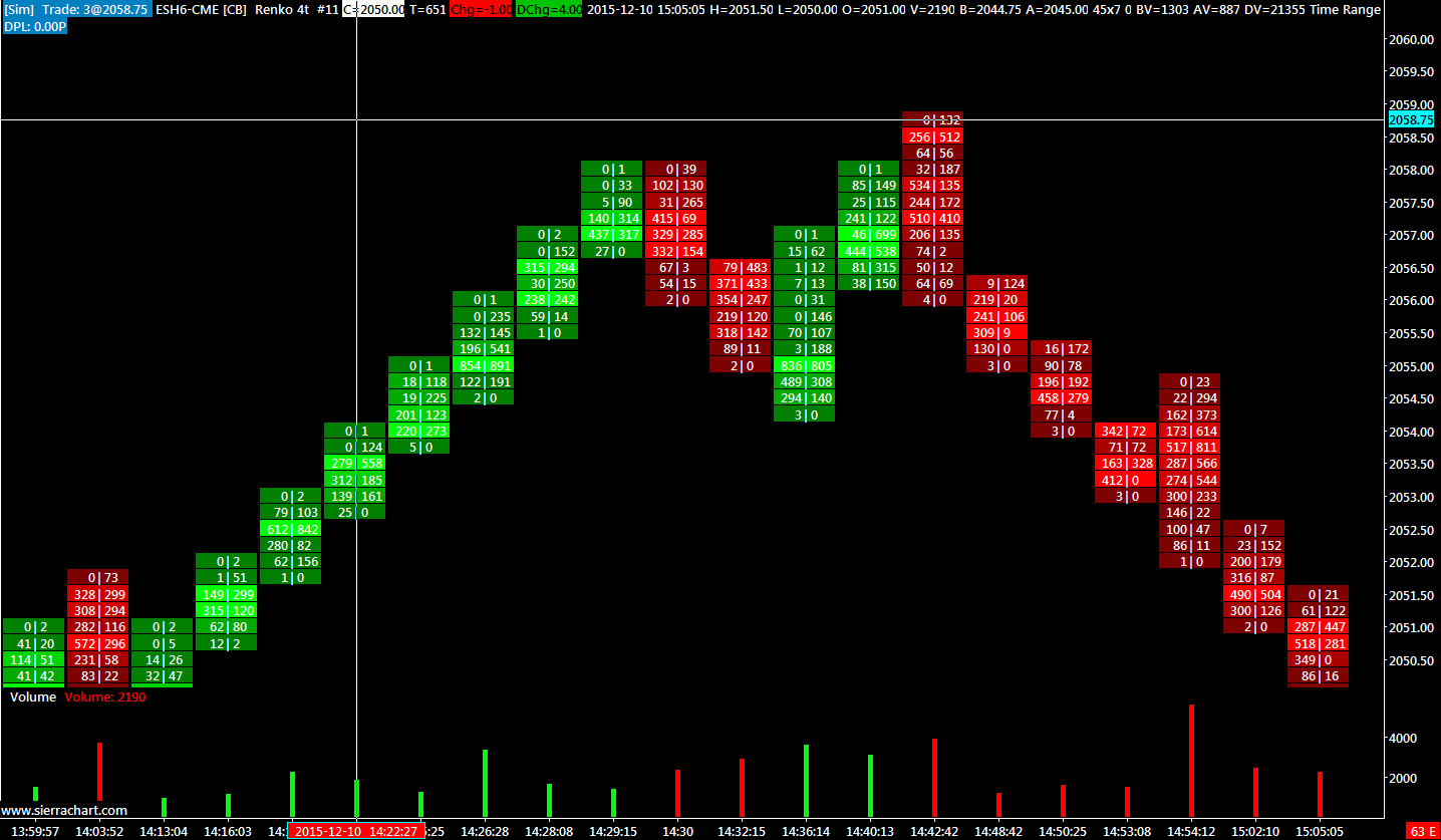

The Numbers Bars are not restricted to 4 ticks. It appears (see attached)that the Numbers Bars are the same in Range as if the source Renko chart had a setting of "Renko Brick with Wicks". The source Renko Chart is set to simply "Renko Brick". My goal was to see only 4 tick Bricks/Numbers Bars.
http://www.sierrachart.com/image.php?l=1449815833137.png

We need to make a correction. When we talked about it not being 100% accurate, we were mistaken about that. We were thinking about applying the Numbers Bars study to a chart that is using a study to replace the main price graph like the old Renko Chart studies.
So the data displayed with Numbers Bars for Renko chart bars is 100% accurate.
What you see is normal. Numbers Bars are going to display all of the price levels at each chart bar.
Changing the Graph Draw Type is totally meaningless.
And no, we are not going to change this. We would never do that.

Numbers Bars is a type of Graph Draw Type. So when that is being used, any other type such as Renko becomes irrelevant.
Even when you put the Point and Figure Chart study on the chart and also the Numbers Bars study, the Numbers Bars study will show a High to Low range which is greater in some cases than the underlying Point and Figure bars.
It is completely logical and orderly. We would never get involved with adding code for a particular selected Graph Draw Type to purposely skip over price levels which actually exist in the underlying data. That is a huge mistake.
Also, you are mixing Graph Draw Types and Bar Period Types in your comments. These are separate. For example, a Range Bar is different than a Candlestick Bar. A Range Bar can be drawn using various Graph Draw Types including Candlesticks and Numbers Bars.
