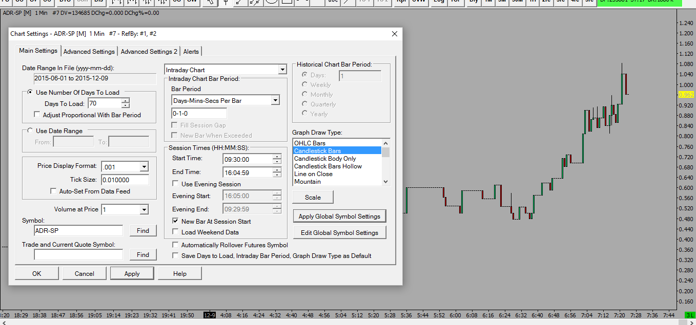

See attached picture of the Chart Settings for this symbol and underneath the 1 min chart plot.
I only want this to plot on the chart for the day session ie 9:30am to 4:05pm USA ET.
Why is it continuing to plot time periods outside of this range?
I do not want plots outside the day session as they are erroneous - as you know these market statistics symbols are based on the Cash Indexes which are only open for the day session, so any data outside this time period is erroneous and often mucks up the vertical scaling.
In fact when I set the Chart Settings to the day session only and then save it, I get the chart plot shown. If I then go back into Chart Settings the day session times have been over-ridden and now show 18:00 to 17:15 (which is why the erroneous data is showing). But why is the time session being automatically changed? I have checked the Global Symbol settings and they are correct.

Market statistics are calculated from stock data. And there is stock trading outside of the normal day session. The data definitely is not erroneous.
The problem is the chart is being referenced by 2 other charts and the Session Times are being changed to match those charts. What studies are you using to reference this chart?

[2015-12-09 16:22:41]
User13668 - Posts: 296
Overlay (Single Line) study is being used to reference this ADR chart by 2 other charts.
Yes those two charts have extended hours session times ie 18:00 to 17:15.

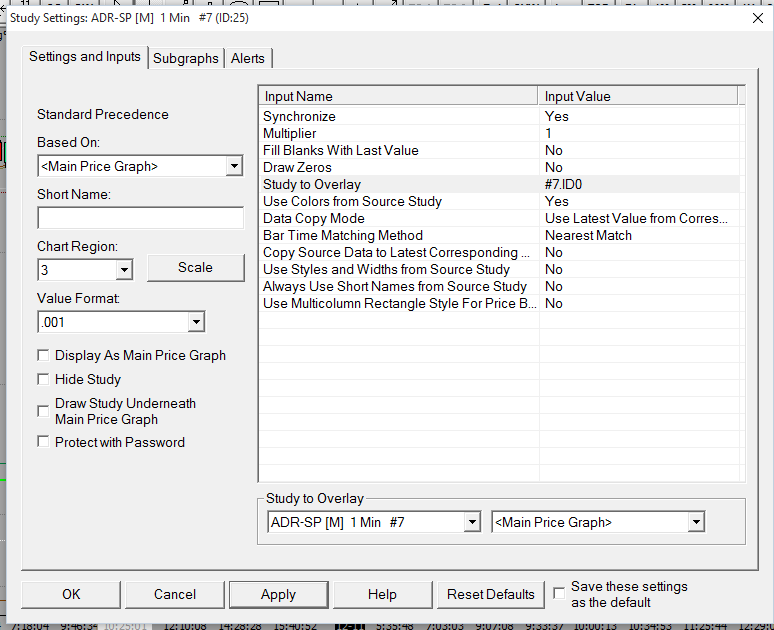

[2015-12-12 17:39:55]
Okay I have switched to the Study/Price Overlay study and that now allows me to have different session times on the Source and Destination charts.
However the reason I did not use this Study in the first place is I have never been able to figure out how to display the Overlay on the Destination chart as, say, a line when the plot of the Source chart is the main price graph ie it is Candlestick bars.
When I read your documentation you referred to for the Study/Price overlay it seems to suggest you can overlay the main price graph from the Source Chart on to the Destination chart as a different Draw Style.
See attached for my settings for the Study:
I have tried changing the Graph Draw Type from 'Candlesticks' to 'Line on H-L Average'.
I have also tried changing the Draw Style to H-L Average with it set to Visible and not Ignore.
In both cases, when you save the changes it will not accept them and just reverts to Candlestick settings.
imageSC1_Capture.PNG / V - Attached On 2015-12-12 17:39:32 UTC - Size: 37.76 KB - 452 views
imageSC2_Capture.PNG / V - Attached On 2015-12-12 17:39:43 UTC - Size: 44.18 KB - 407 views

One thing we realize now is you just need to change the Graph Draw Type in Chart >> Chart Settings for the source chart to do what you require.
[2015-12-13 21:10:17]
