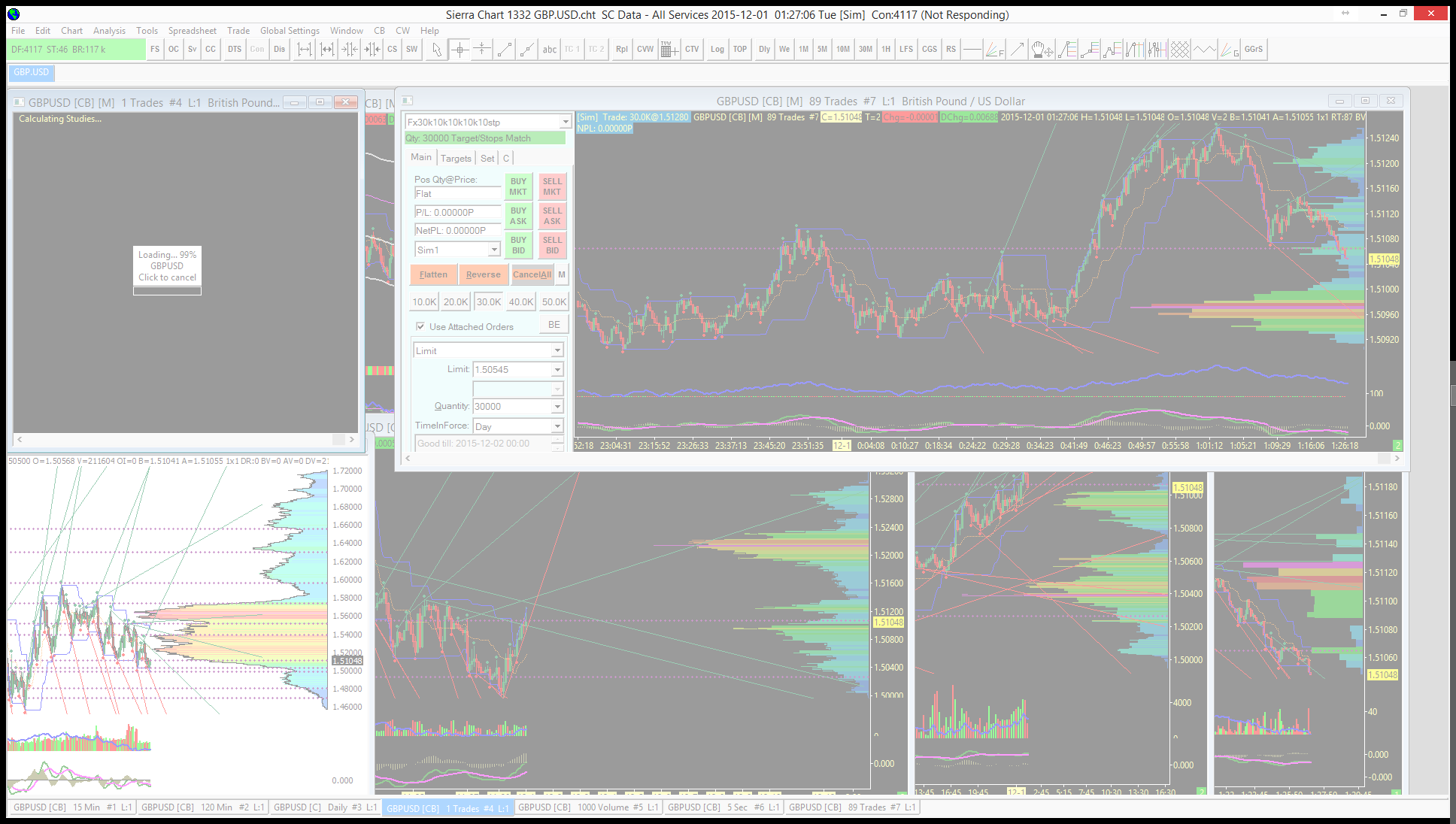

eugen - Posts: 2
It's stopping/freezing when its reaching 99% then it stays there for ever. I need to shut it down from Task Manager and restart. I am using the most most recent version but it did the same with a previous version (..29).
I use Windows 8.
imageScreenshot 2015-12-01 01.27.37.png / V - Attached On 2015-12-01 09:35:57 UTC - Size: 152.25 KB - 466 views
[2015-12-01 09:57:51]
Follow the instructions here to delete the data file for GBPUSD:
Chart Data and Chart Data Files: Deleting a Chart Data File
Run the Windows Error checking Tool on your drive.
[2015-12-01 10:03:09]
eugen - Posts: 2
I managed to get rid of the issue by removing all the studies, changing the chart to desired 10,000t (or something else) then re-applying the studies and it works.
[2015-12-01 10:10:29]
OK therefore it is definitely caused by a study. One of the studies is using a lot of CPU usage.
But if you no longer have the problem maybe there was a particular study setting which was causing the problem that is no longer being used.
