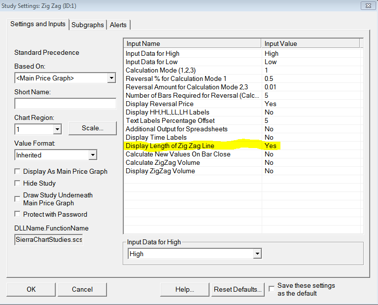

[2013-06-20 22:42:02]
M5amhan - Posts: 468
with the zig zag study you need to have "Display length of Zig Zag line" checked to "yes"
settings are attached in the image
here is the formula:
=OR((ID1.SG4>3),(ID1.SG4<-3))
this is assuming "Zig Zag" is ID1.. you can change as necessary and also assuming "ZigZag line length" is SG4 you can also change that as necessary
Date Time Of Last Edit: 2013-06-20 22:44:12
imagesettings.PNG / V - Attached On 2013-06-20 22:42:00 UTC - Size: 35.2 KB - 1111 views
