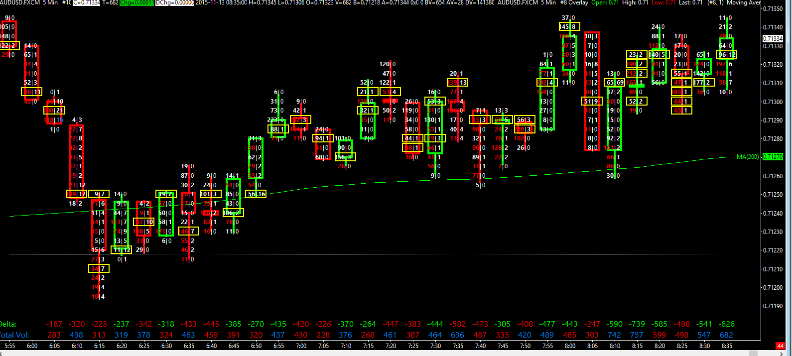

Sirs,
My chart changed all of a sudden when I appied number bars. Cumulative delta does not match with number bar delta. Is there a bad setting? What can be done?

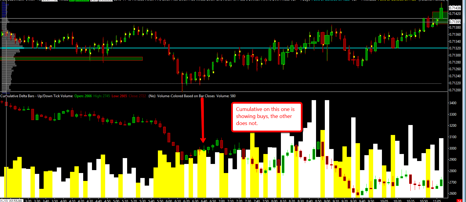

Dear Sirs,
I have downloaded the same template my buddy did, and his is actually showing buyikng volume when mine only shows sell. I use IQ feed and he uses the standard fxcm data. For him the cumulitive delta does not work properly, for me the number bars and the delta associated does not work properly. Is there a way a setting could be fixed?
The only way this is going to work properly if is if the bid ask average is used when constructing the chart bars and determining the bid volume and ask volume. We have set that now in the symbol settings for IQ Feed FXCM symbols. This also requires a Sierra Chart update.
Update Sierra Chart with Help >> Download Prerelease. You must get the prerelease.
Update the Symbol Settings here:
Re-download the data in the IQ Feed FXCM Forex charts with Edit >> Delete All Data and Download.
All of what we describe above is an absolute must and there is no way around this. The Bid Trade Volume and Ask Trade Volume are simply going to be wrong otherwise with IQ Feed FXCM data.

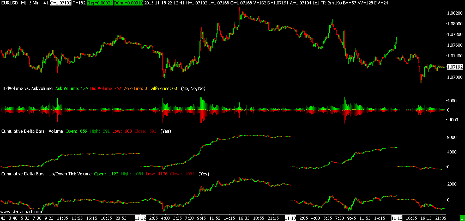

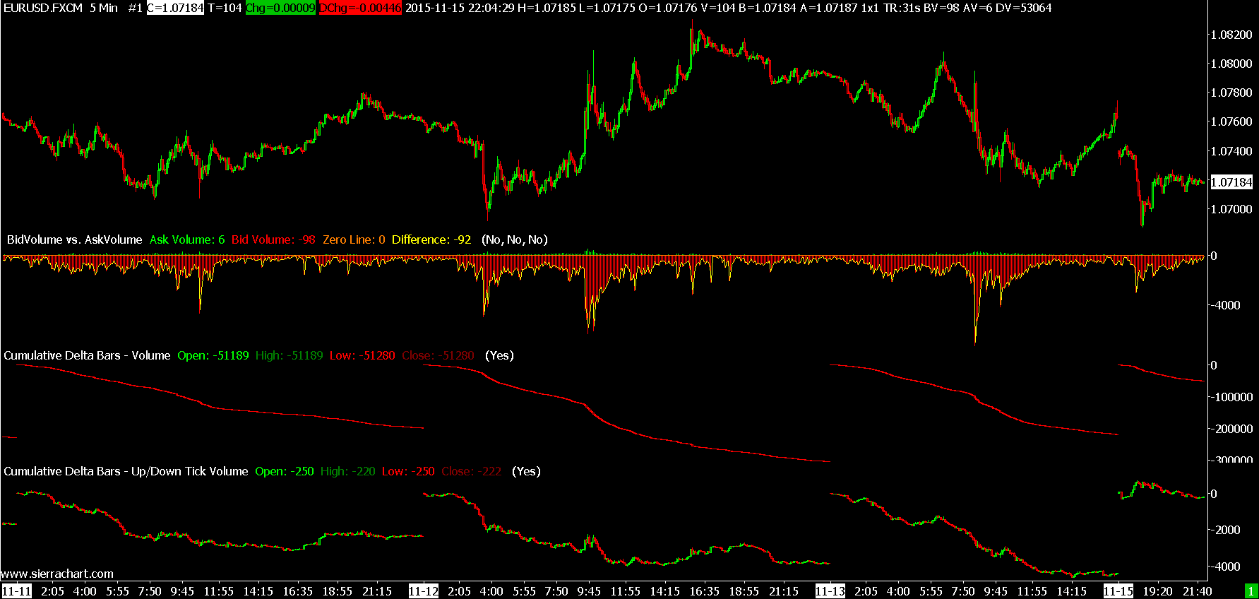

This cannot be with the IQ Feed FXCM symbols. Have a look at this:
http://www.sierrachart.com/image.php?l=144764307254.png
Notice how all of the Cumulative Delta Bars graphs trend down. This is how it currently is until the changes we made in the latest prerelease.
Now look at what happens when the Bid and Ask Average is used with the same symbol which it needs to be for the proper calculations:
http://www.sierrachart.com/image.php?l=1447643463472.png
but the issue with the cumulitive delta went unresollved for the longest time.
There are no problems. There only exists a misunderstanding. We will help to clarify that.

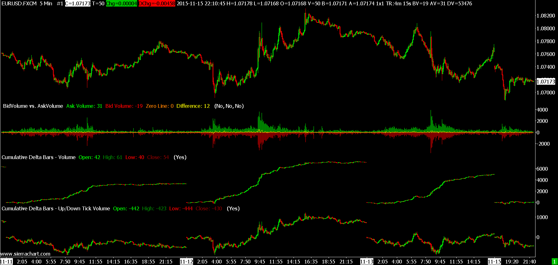

Here is the Cumulative Delta Bar graphs from the FXCM data provided from Sierra Chart:
http://www.sierrachart.com/image.php?l=1447643577419.png
