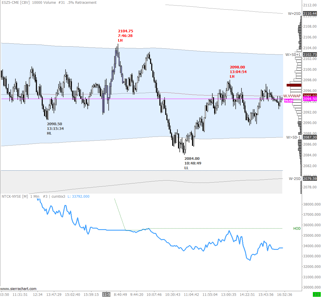

I am using a Daily OHLC study to monitor to intraday highs/low on a cumulative tick study I created using Ntick. I have ignored the open and close line in the subgraph properties and I have both High and Low selected as line and dot...While High is graphed, there is not graphing of the Low as shown in the picture attached
http://www.sierrachart.com/image.php?l=144675920715.png
how can I fix this

And what is the value of the Daily OHLC >> Low at the end of the chart?
Use the Chart Values Tool to determine this. Here is the documentation:
Chart Drawing Tools: Chart Values/Crosshair
If there are only zero values, then this explains why you do not see the line.

yes, it shows zeros, but why would it be a nonzero value the for the high and open but zero for the low and close?
[2015-11-09 00:49:06]
We do not know exactly what the study configuration is but the Daily OHLC study, requires valid Open High Low Close values. Apparently the study it is based on does not provide those. So it will not work properly.
