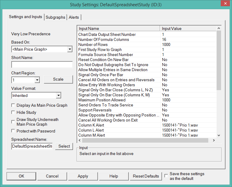

I have run the Replay again with my own Spreadsheet for Trading. Still no trades are being opened / closed. Only arrows do appear where the actual positions are to be opened / closed.
Chart no. = 1. Sheet no. = 1. Refer to print screens.

In general what you need to do it set the Signal Only on Bar Close Inputs to No to simplify the configuration.
And change the formulas you are using to simple 1 and 0 values. From there, you can gradually make changes until you determine what the problem is.
We do not provide automated trading system debugging and we do not know what the problem is. We can only provide you good and clear well-written documentation of explaining how everything works and it is up to you to determine the problem. We will add the above information to the documentation.
