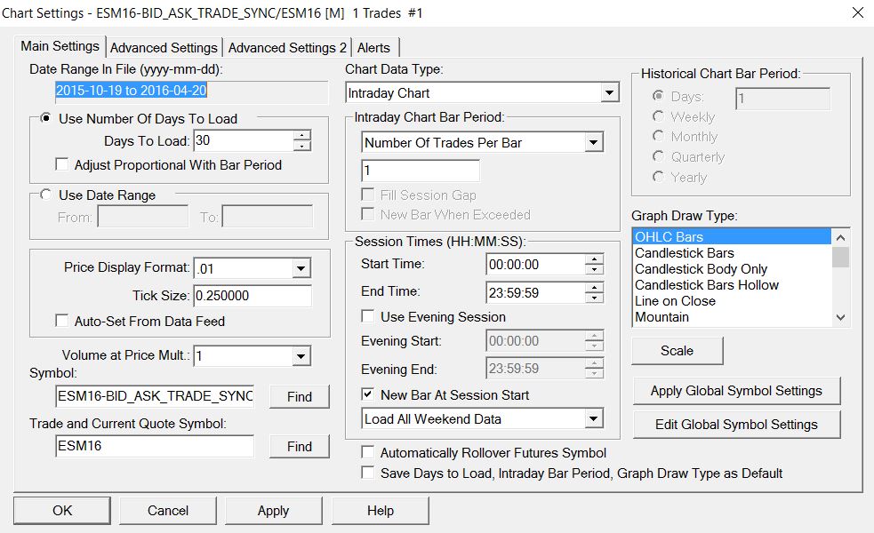

Hi SC,
I did the following three things:
1. installed version 1397
2. Download historical intraday data from your server for symbol ESM16-BID_ASK_TRADE_SYNC
3. Made a chart for ESM16-BID_ASK_TRADE_SYNC with the setting shown in attached screenshot 1.jpg and then added the "Bid & Ask Prices" study to the chart.
For some reason it is still only showing the Bid and Ask prices on Last prices and not on and/or in between Last prices.
Any idea why this is?
Thanks,
P.S.
I also tried this with the symbol ESM16-ALL instead of ESM16-BID_ASK_TRADE_SYNC, but the problem was still the same.
image1.JPG / V - Attached On 2016-04-20 22:33:12 UTC - Size: 123.6 KB - 573 views
[2016-04-20 23:17:50]
That data recording suffix only affects real-time stored data.
Also, you will always see the last trade price that was last received every time there is a Bid and Ask update.

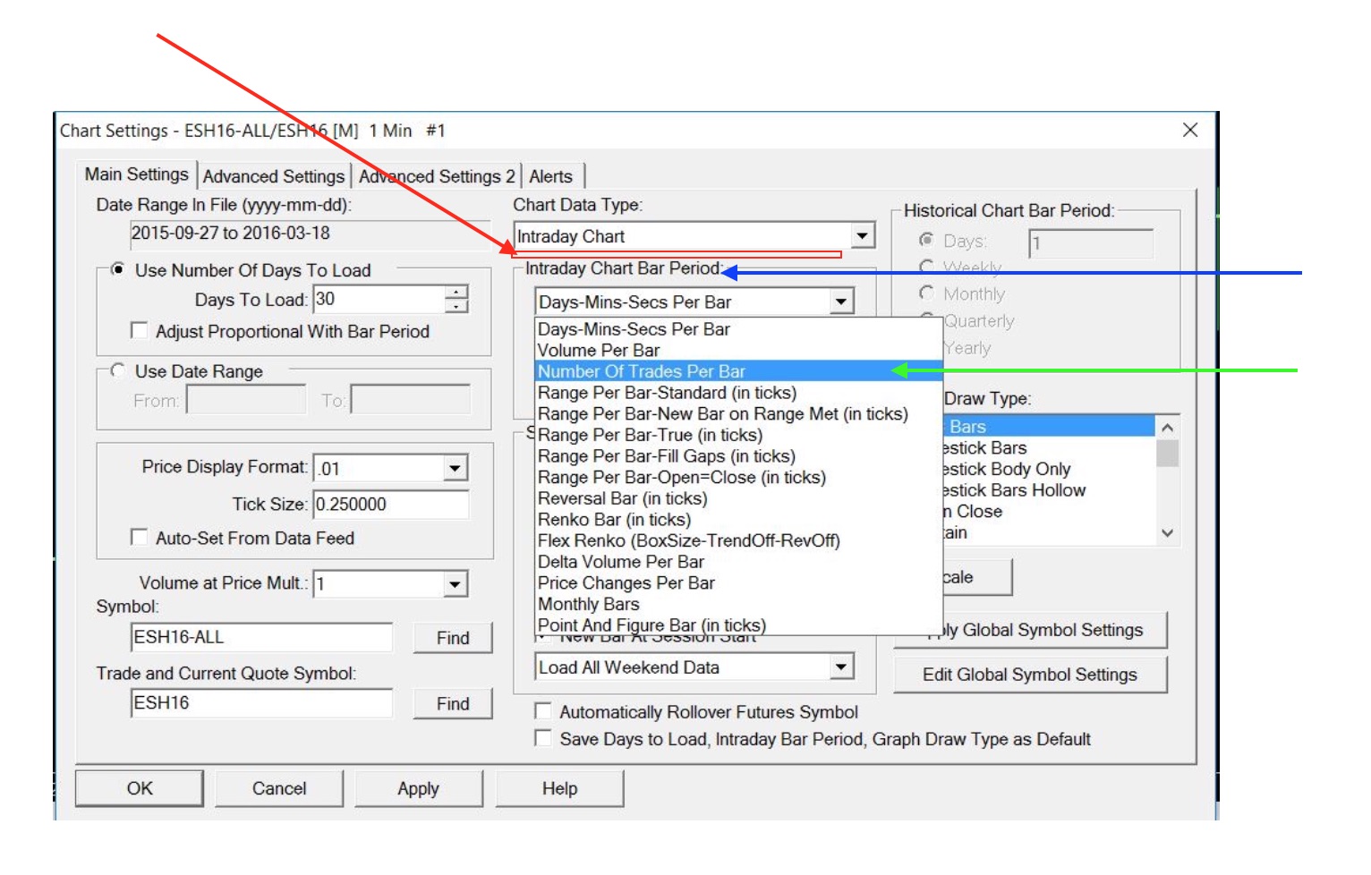

Here is a simple real life scenario of what I (and probably some of your other users) am trying to accomplish. Perhaps there is an alternative solution (such as the "Study/Price Overlay Study" explained here http://bit.ly/1qErtIN ) you could recommend? (FYI, just to be clear, when I say "1 Tick Bid Bar" below, I am referring to any change in Bid Price and/or Bid Volume that happens ON OR in between Last prices. Same situation regarding Ask Price and Ask Volume when I say "1 Tick Ask Bars" )
My strategy's Long Entry signal is based on 1 minute Last bars. However, its Long Exit signal is based on analyzing (rather complex) changes in volume and price of 1 Tick Bid Bars. Because the exit signal is rather complex, its pretty much impossible for me to test to see if I've programed it right unless I can view the 1 Tick Bid Bars in the backtesting results.
It would also help a lot if in the backtesting results I could also see 1 Tick Ask Bars and 1 Tick Last Bars alongside the mentioned 1 Tick Bid Bars (all in the chronological order they happened in) because this would let me test to make sure I didn't accidentally program my exit strategy to respond in any way to 1 Tick Ask bars and/or 1 Tick Last Bars instead of 1 Tick Bid Bars.
Thanks,
P.S.
I'd also like to mention that adding 1 Tick Bid Bars and 1 Tick Ask bars (as they are defined above) to a chart is a standard feature in both Ninjatrader and Multicharts. I feel Sierrachart is a far superior platform to both of them and don't understand why SC does not have this ability.
Also, the feature/capability I'm requesting is very much in your broker's interests. This is because this feature/capability is pretty much a requirement when doing high frequency trading. And high frequency trading equals more commissions for your brokers.

Here is what I suggests regarding getting this data into Sierrachart
(note: Its very important you support real milliseconds (or even microseconds or nanoseconds) rather then "counter milliseconds" so this data can be kept in synch on a subsecond level)
At a minimum:
-Allow users to import it from .CSV/.TXT files
-Allow users to record it from live incoming data
Would be nice, but not required:
-Allow users to download it from the servers of any brokers who offer it (such as AMP)
-Start recording it yourselves and let users buy/download it from you for an additional monthly fee (Id definitely be happy to pay extra per month for it.)
Here is what I suggests regarding accessing/using this data once it is in Sierrachart
(FYI: The following description is very similar to how the other trading platforms i mentioned do this.)
-In the area pointed to by the red arrow in attached 1.jpg add a dropdown that lets the user select one of the following: LAST, BID, ASK or MID. Their selection will determine if the "Intraday Chart Bar period" (pointed to by the blue arrow) will be based on the LAST, BID, ASK or MID.
-All options in the "Intraday Chart Bar period" will remain the same if BID, ASK or MID is selected (instead of LAST) except for the option pointed to by the green arrow in 1.jpg.
If BID, ASK or MID is selected the option pointed to by the green arrow in 1.jpg will say "Number of Ticks" per bar rather then "Number Of Trades Per Bar"
Date Time Of Last Edit: 2016-04-21 05:09:14
