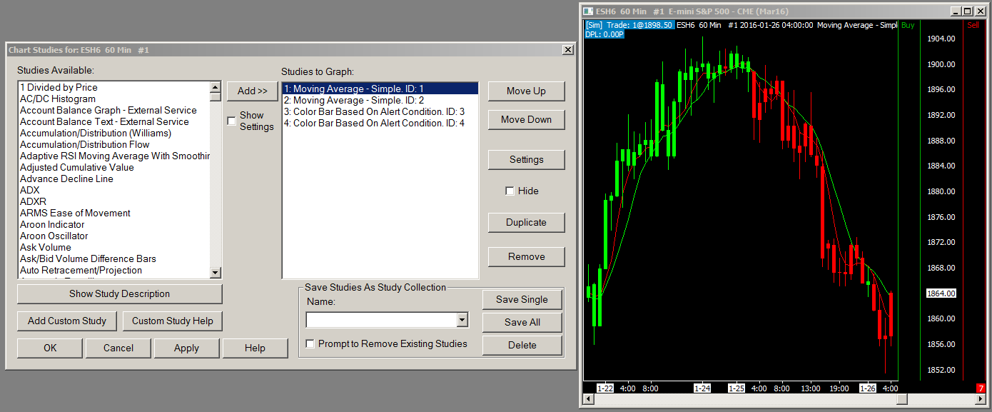

It works for me. See pic.
imageUser66360.PNG / V - Attached On 2016-01-28 16:28:05 UTC - Size: 78.45 KB - 729 views
