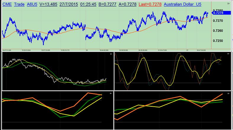

Is it possible to create something almost similar to this extent?
I am currently using the Sierra charting and notice it might actually be able to.

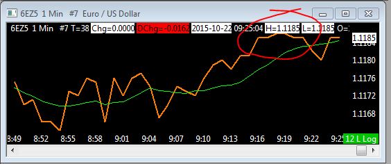

However, I am stuck with the lower time frame windows. The charts are unable to fix the lower time frame charts as like what is shown in the screenshot.
In sierra, the fixed horizontal lines move up and down the window when the pricing shifts out of my chart.
Capture.JPG is my sierra(the red circles are when they go out of the charting window).
Ar5Efv... is the charts i am trying to accomplish.

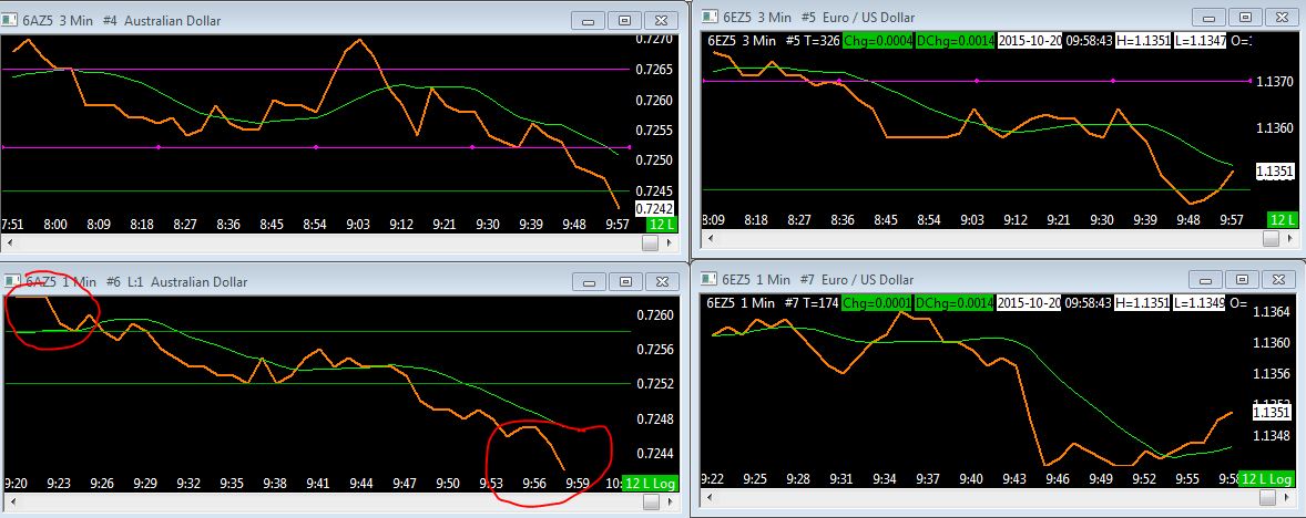

Good day,
Followed the steps but the lines are still shifting out of charts.
imageCapture.JPG / V - Attached On 2015-10-22 14:25:55 UTC - Size: 36.84 KB - 448 views

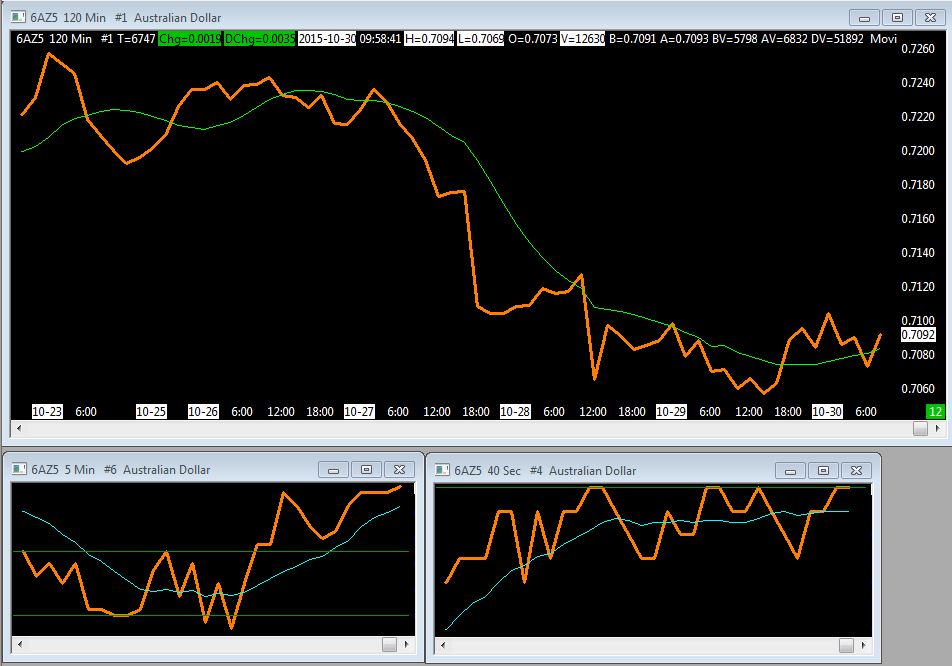

I managed to play around the settings and am getting nearer to where I desire the charts to be.
As attached below.
If you do notice the horizontal line still shifts around when the Lines are shifting out of the intraday chart.
How do I keep the line on close and horizontal lines within the intraday chart?
imageCapture.JPG / V - Attached On 2015-10-30 15:00:57 UTC - Size: 98.3 KB - 514 views
