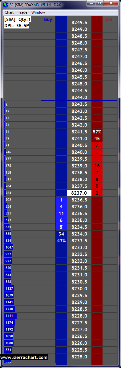

I've upgraded to SC v989 and I have some strange things on the DOM
http://www.sierrachart.com/image.php?l=1371558809477.png
With this the DOM is useless.

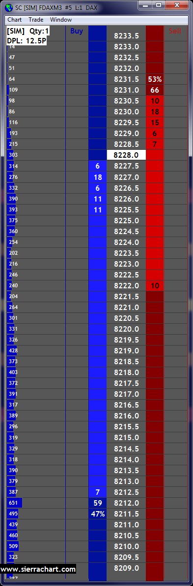

A new one
http://www.sierrachart.com/image.php?l=1371575668503.png
You can also see some refresh problem at 8234.5

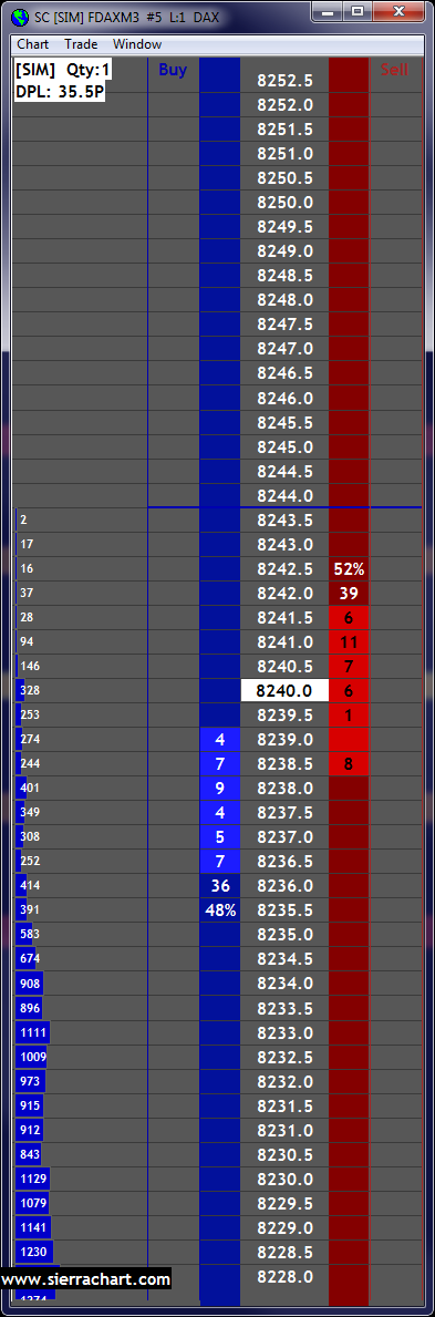

And this one when I was writing this message :
http://www.sierrachart.com/image.php?l=137157590442.png

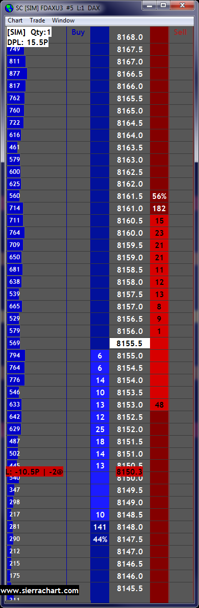

And the last one for today : http://www.sierrachart.com/image.php?l=1371581550932.png

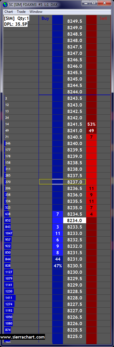

doctor.scalp - Posts: 18
Hello
I don't know what the OEC team is doing but the Market Depth is back to normal today, 10 levels ! but the bug is still here :(
http://www.sierrachart.com/image.php?l=1373547693405.png
[2013-07-16 07:39:36]
We have done some testing with this. We do observe the problem and we have contacted OEC about it.
