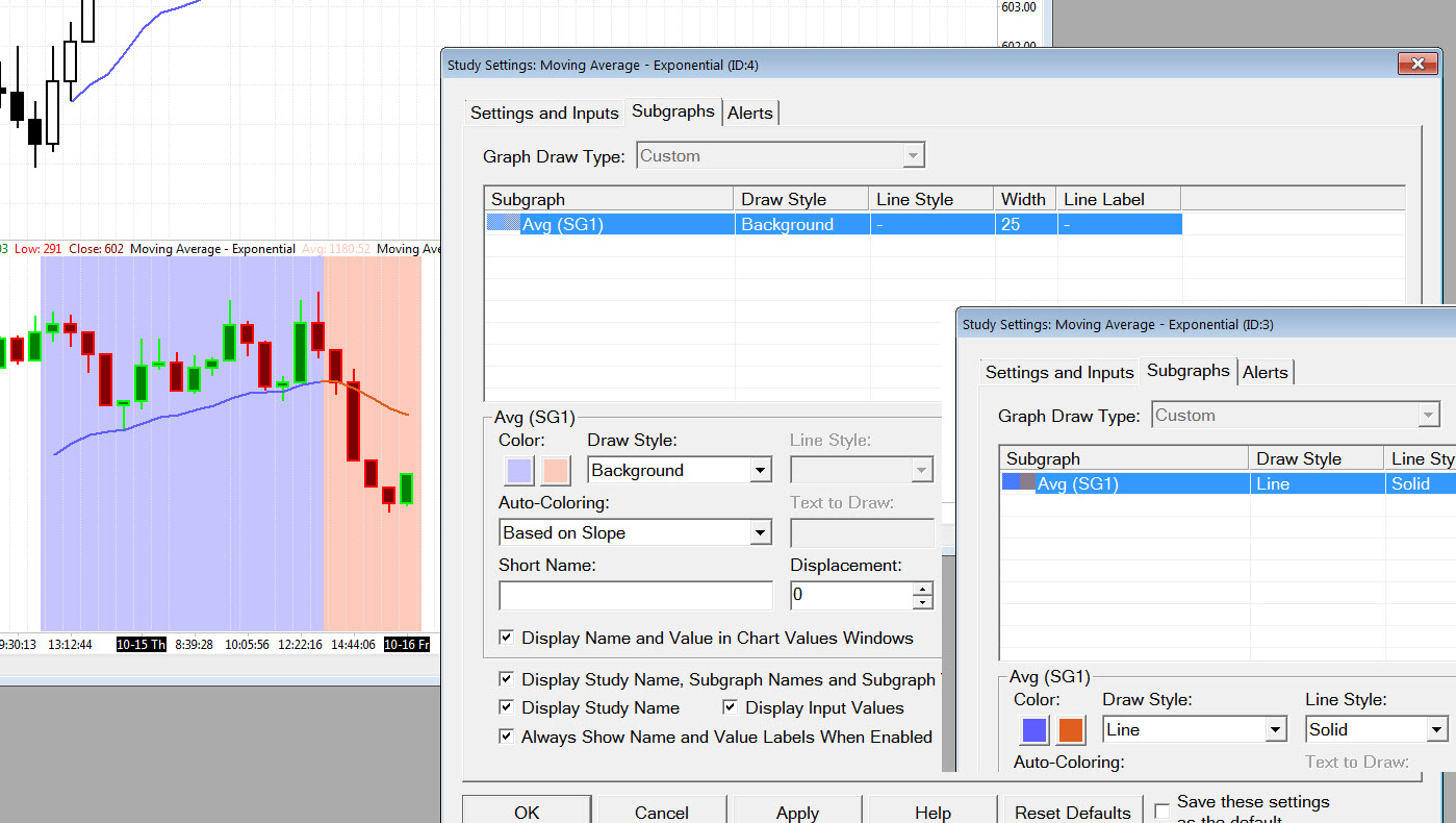

[2015-10-16 10:24:07]
Joe Hobart - Posts: 89
i will often use a duplicate of the study, or a Study/Price Overlay and just set it to use background style
imagebackgroun.jpg / V - Attached On 2015-10-16 10:24:02 UTC - Size: 303.49 KB - 519 views
