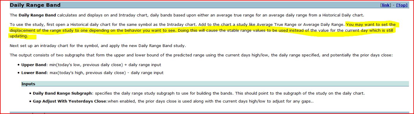

See attached screen grab of your documentation for the Daily Range Bar study.
The highlighted piece says to apply a displacement to the ATR study (or ADR study if using that one) so that the ATR is caluclated EXCLUDING today's trading - this is what I want.
However neither of the ATR or ADR studies offer a displacement option in 'Setting & Inputs'.
Could you confirm that therefore by default both the ATR and ADR studies EXCLUDE current days trading.
imageSierraCapture.JPG / V - Attached On 2015-10-07 11:52:53 UTC - Size: 119.83 KB - 648 views
[2015-10-07 19:46:30]
The documentation is incorrect. The study Subgraph Displacement setting is not going to have any effect and is not supported. This is going to be removed from the documentation later today.
