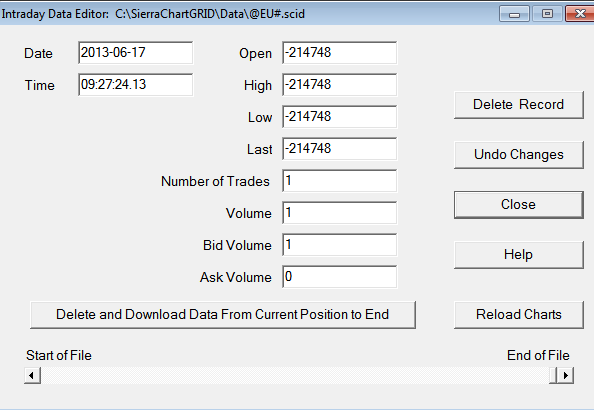

anyone else havin bad ticks with iqfeed? not sure of SC or IQfeed?
View Count: 2553
[2013-06-17 15:47:16]
User22396 - Posts: 191
all morning and various futures symbols I have been havin the occasional large negative values on a 1 lot trade...edit data-intraday cleans it out but very annoying
attached is a recent example (mountain standard time)
running 988 so not sure if iqfeed issue or SC issue?...have contacted iqfeed as well
thanks B
imageiqfeed.png / V - Attached On 2013-06-17 15:45:34 UTC - Size: 14.51 KB - 918 views

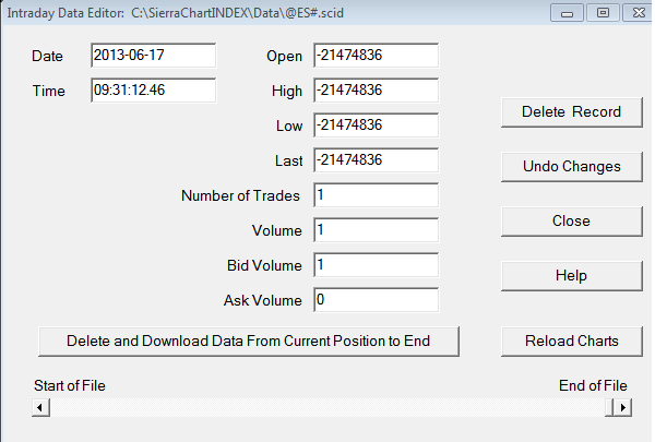

[2013-06-17 15:54:36]
example of an @eu# negative tick
imageiqfeed eu.png / V - Attached On 2013-06-17 15:54:18 UTC - Size: 14.38 KB - 837 views
[2013-06-17 16:24:10]
from iqfeed...
We are having some problems that are being looked at. Negative values are
still occurring in streaming data. You can try to disconnect from Iqfeed
and connect again to see if you can get on a different server. We will have
this fixed shortly.
[2013-06-17 17:14:19]
This is an IQ Feed problem. We have reported the problem to them as well.
If you are having any trouble with Sierra Chart freezing or using a lot of memory, please refer to:
This is what we have discovered:
This morning IQ Feed has transmitted errors on many of their symbols which are way off price. This is causing problems with studies like the TPO Profile Chart study and the Volume by Price study to allocate huge amounts of memory. These studies do have the ability to manage this type of problem but this error is so significant that it is still causing excessive memory use and causing Sierra Chart to freeze.
This is the procedure to correct the problem:
1. Terminate or restart Sierra Chart.
2. Do not open any of your Chartbooks. If you have Chartbooks set to automatically open, then quickly go to Global Settings >> General Settings and remove all the Chartbooks from the Files To Open On Startup list. Press OK.
3. Go to File >> Find Symbol and open an Intraday chart for each of the symbols you have Intraday charts for in your Chartbooks.
4. Look at the charts. If there is a data error, it will be very obvious. Right-click before that data error and select Delete Data and Download. Press Yes to confirm. You might need to scroll back the chart in time to spot the data error.
5.Once all of the data errors are corrected, you can then open your Chartbooks without a problem.
6. Let us know if you need more help.
We do apologize for this, but this is an unexpected issue have to do with bad IQFeed data. It has nothing to do with the new Sierra Chart version. If you updated, it is merely coincidental that this problem has occurred today. It is due to an IQ feed data error.
