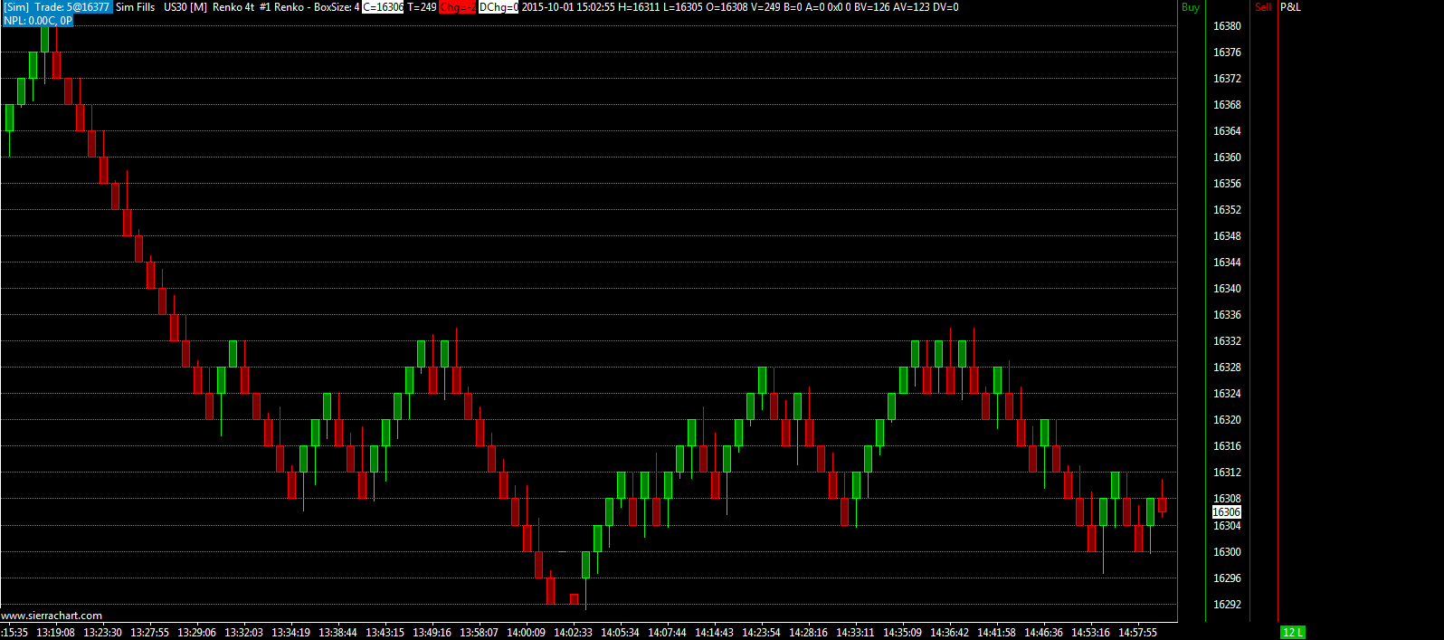

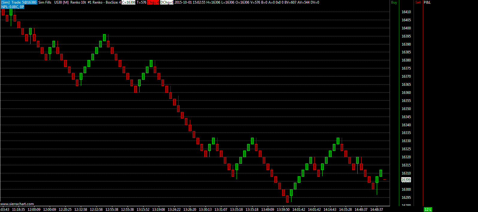

To visualize:
Underlying Renko Brick size set to 10, enhanced Renko at 4:
http://www.sierrachart.com/image.php?l=1443707391718.png
Underlying Renko Brick size set to 4, enhanced Renko at 4:
http://www.sierrachart.com/image.php?l=1443707497159.png
Brick size in both cases the 4 of the enhanced Renko, but with the underlying Renko at 10 the chart, while maintaining the same brick size, is still far slower ?
