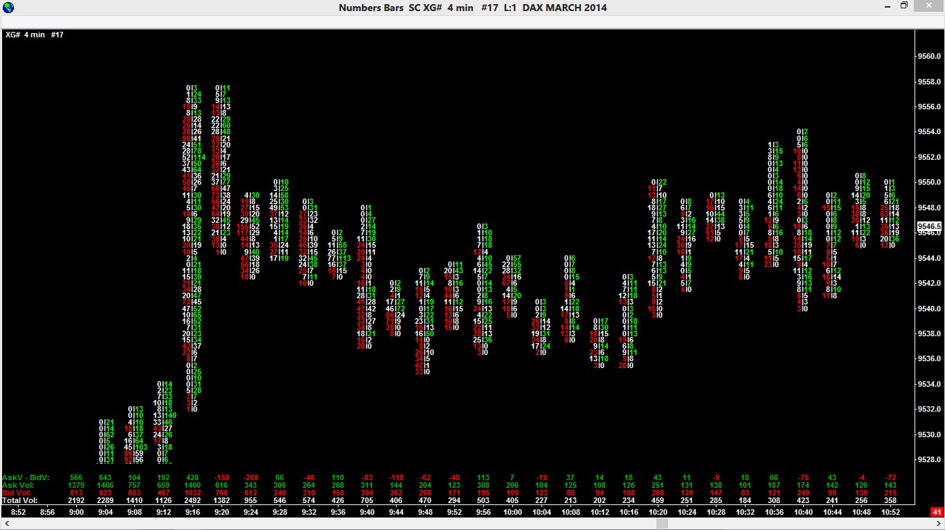

Hi, I have a requirement to to have one of my charts display a number bar chart. I have a view of a chart that I need to emulate but I am having issues, I have attached two images that shows one that I have and another that I need to copy. On my one the numbers are displayed so small that I cannot use the chart, if there was such a thing as a magnifying option it would help, perhaps there is one but as yet I have failed to find it.
If someone could help me with this it would it be appreciated, as I have lost a lot of time trying to get this right :-(.

Refer to this section here about this:
https://www.sierrachart.com/index.php?page=doc/doc_NumbersBars.php#Scaling
The primary thing you need to do is increase the spacing between the chart bars.
