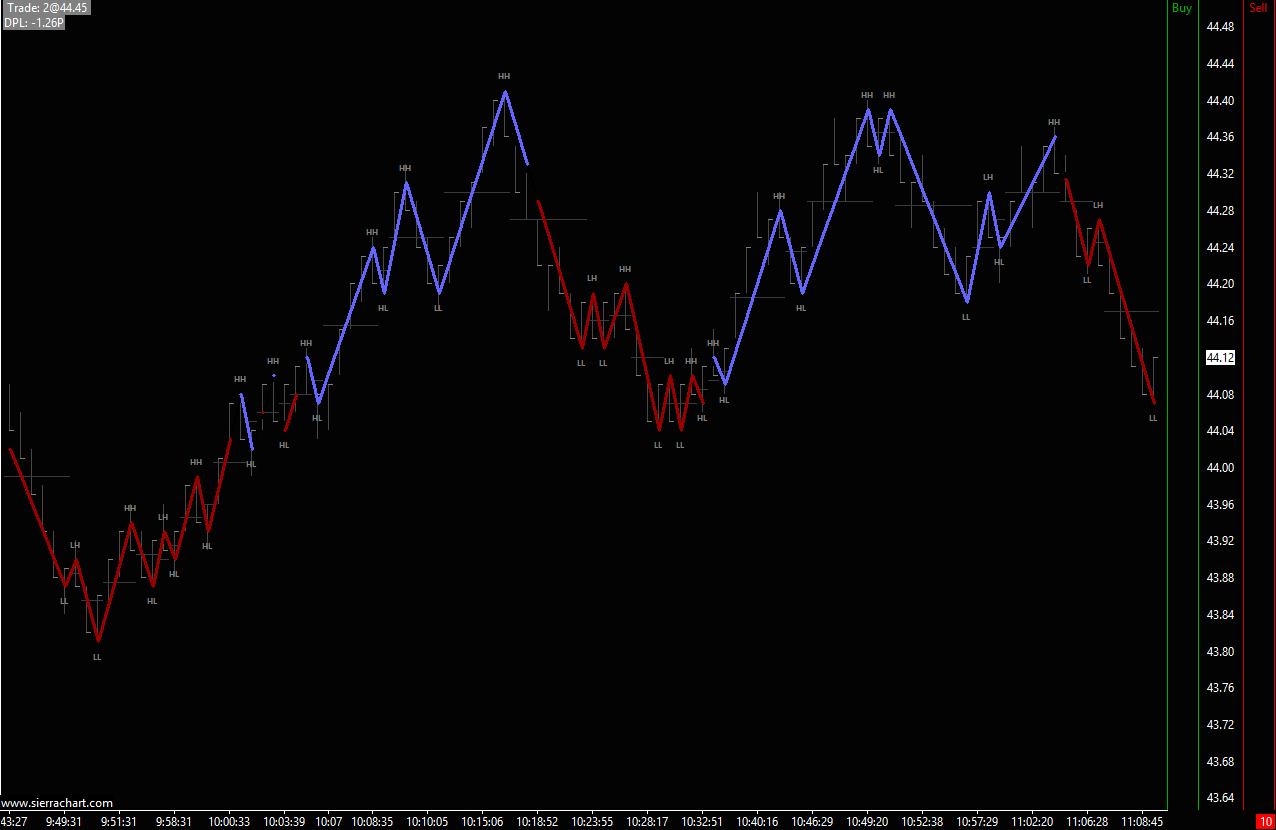

User890810 - Posts: 6
Thank you. I finally was able to code it. Still having one issue. The Zigzag is missing sections of its line. I used line skipzeros just like the instruction stated.
I used the alertcondition =id31.sg1>0 and id31.sg1<0 for two instances of the colorbar based on alert condition.
Below is a screen shot.

Did you hide the original Zig Zag study?
[2015-09-15 18:55:45]
No its not hidden.
Id1.sg1 set to line skip zeros for draw study.
BUT within the zig zag study i turned off color zigzag line to none. As i do not want to use slope, trend confirmed volume or confirmed volume.
My logic says turn off so the color based on alert condition is being used properly...
But when turned on to confirmed volume it does fill in the blanks on the chart i posted.
But why?? doing it this way i need to recaclulate often as the underlying line color gets squiggly making it distracting.
[2015-09-16 04:24:26]
Thinking about this some more, it is not possible to color the Zig Zag study with the Color Bar Based on Alert Condition study reliably because the Zig Zag study changes at bars earlier than the last bar.
Also because the Zig Zag line is continuous, there should be no need to use Line-Skip Zeros when coloring it.
Date Time Of Last Edit: 2015-09-16 04:25:00
