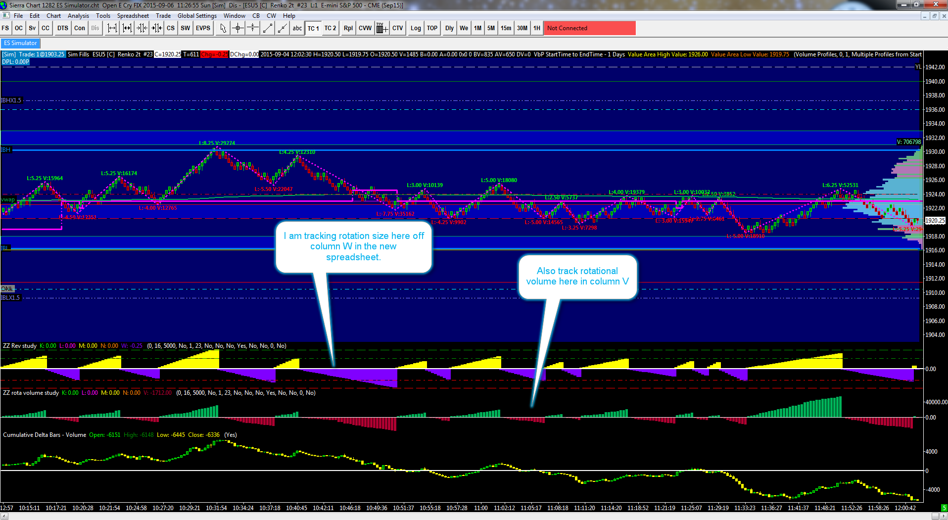

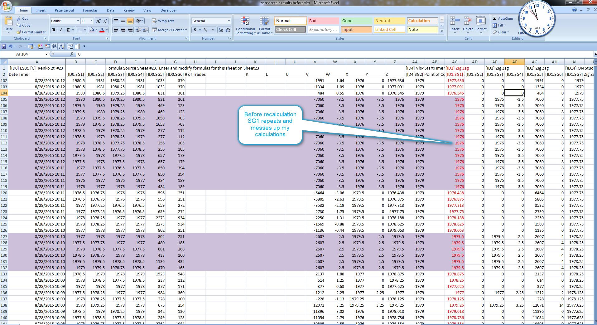

Hope you are having a good labor day weekend; I have been wrestling with why my rotations calculations off the Zig Zag indicator within a (new spreadsheet) are not working requiring constant "recalculations".

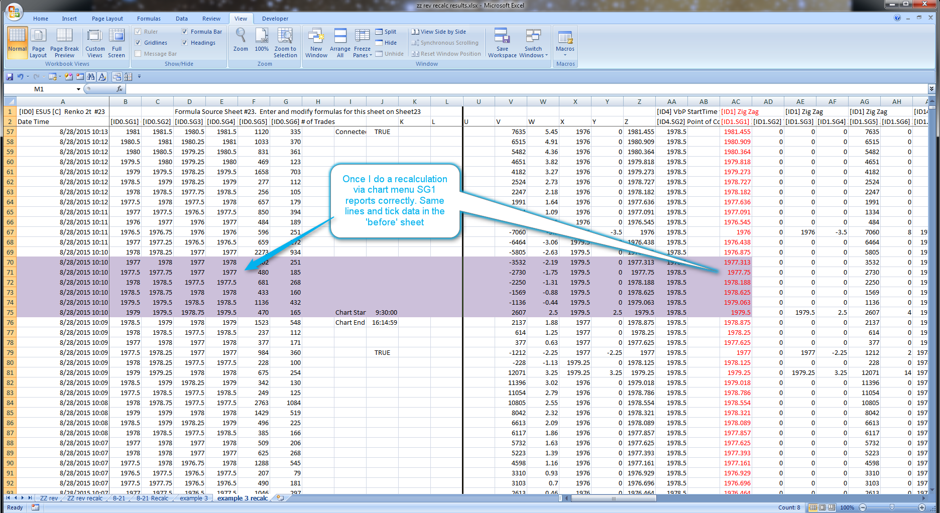

I took some time this weekend to try and find out what is going on and I think I have it pinned down. I copied the data off the SC (new) spreadsheet in real time while this was happening (I saw my rotations appearing off on the chart) and put it into Excel so I could look at it later.
I also copied the data after I did a recalculation and put into an Excel tab next to the 'before' data.
I see that SG1 of the Zig Zag is repeating the same value for several ticks; once I do the recalculation the proper SG1 values appear; I have highlighted the area on the sheets (before and after) and have attached them to this support request.
Could you look at this and tell me is this proper operation of the Zig Zag? And is this a possible bug or have I done something wrong here.

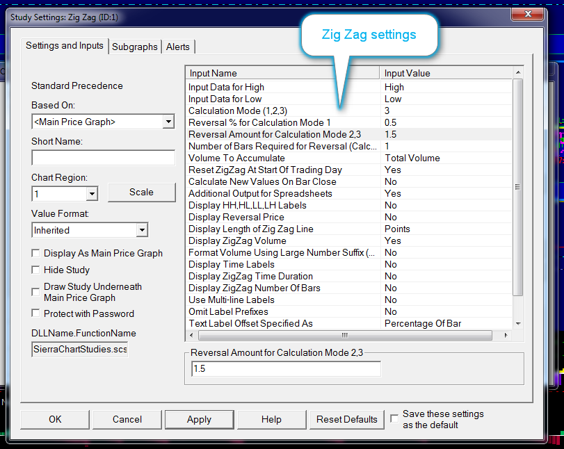

The chart that this is tracking is a ESU5, 2t Renko, OEC data feed and have attached a view of that chart and the Zig Zag settings as well, thx...
Steve

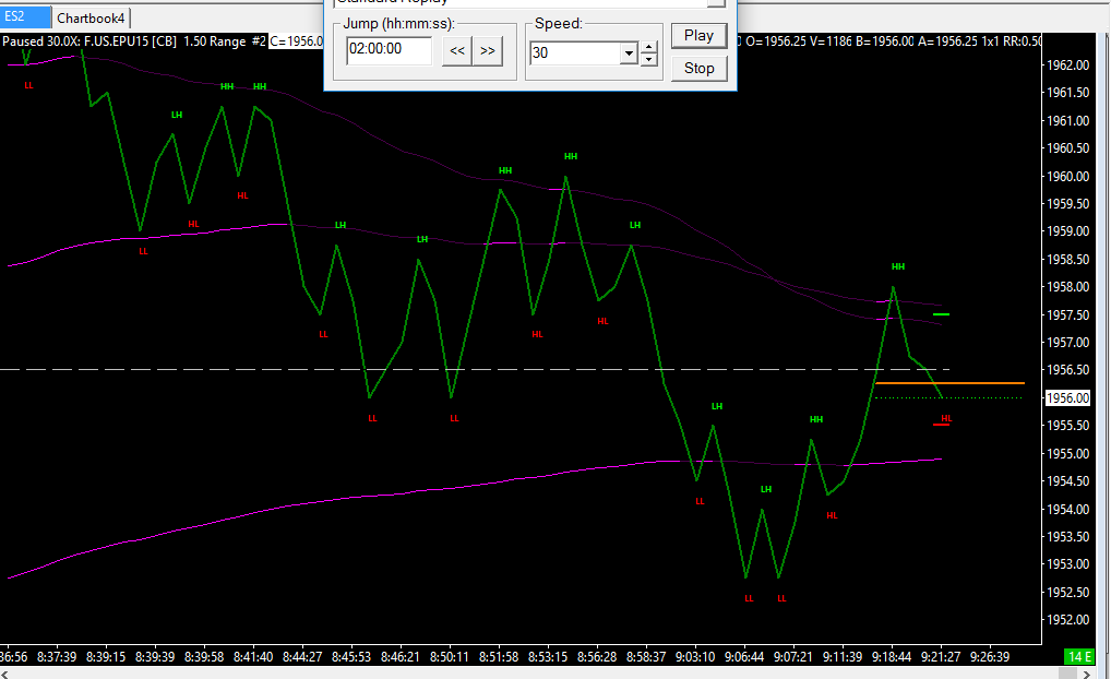

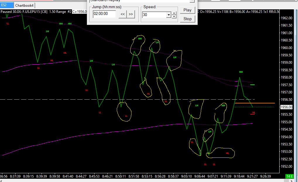

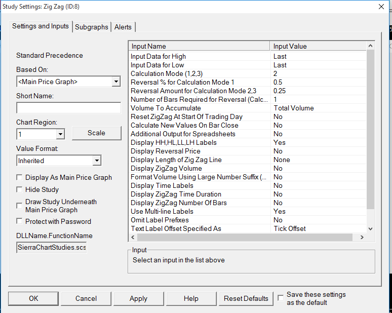

I am having the same problem but with the text output labels for the higher highs and lows. Was going to start my own thread. I use zigzag but use open to open or close to close for input settings. What happens is the high low text labels miss print and i need to constantly recalculate to place them in there proper places above the current swings.
I think you are onto something. You took it a step further with your spreadsheet but i think something is wrong too...
Hopefully we hear something soon.

Regarding post #2, this is a different issue and you are creating your own problem by not referencing the high and low and the issue is already documented here:
https://www.sierrachart.com/index.php?page=doc/doc_TechnicalStudiesReference.html#s133

Regarding post #1, this kind of problem was solved in the past and we are not sure why it continues to occur.
Possibly it has something to do with the settings you are using with the zig zag study.
This is the first we have heard of it recently. It will be looked into in the next 30 days.
