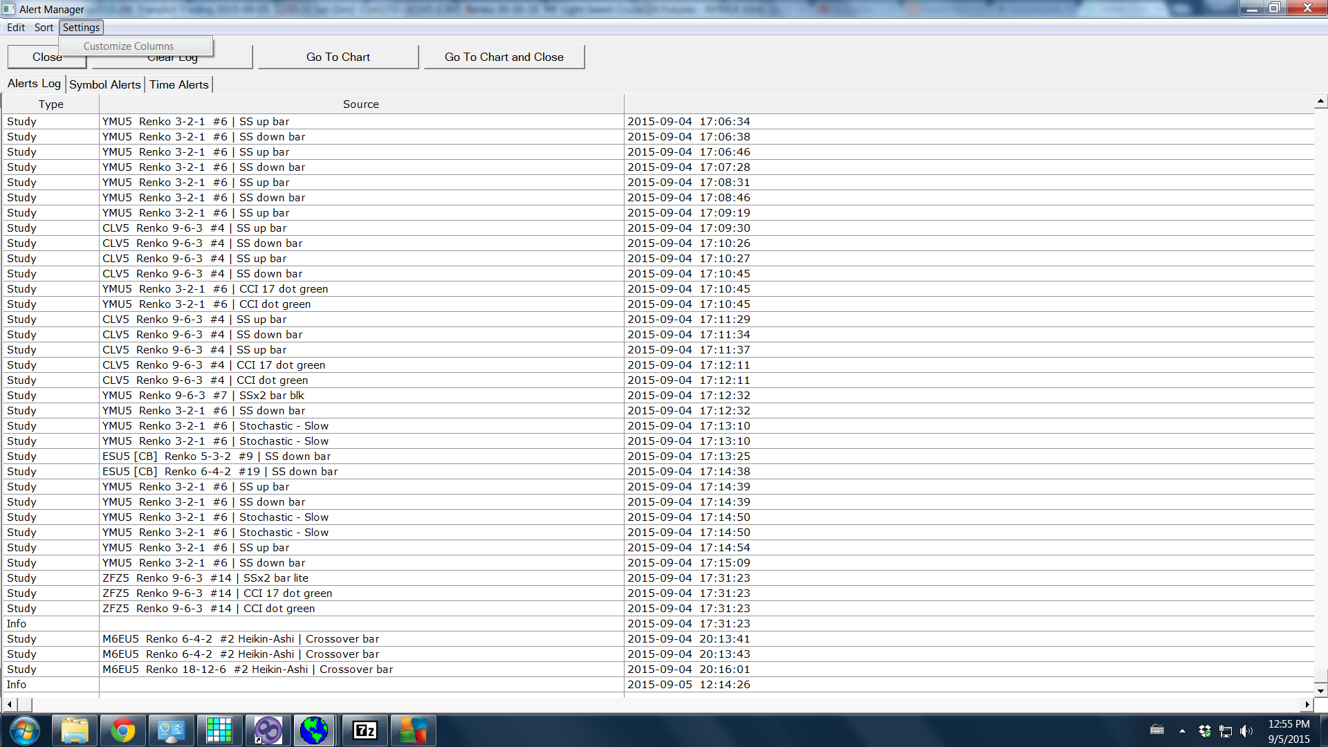

Hi, I see my alert log no longer lists alert sounds in the log. How do I get that functionality back?

mulesrule - Posts: 14
All the alerts are still there in the log (about 30-40 per minute, I wish I could filter/exclude the ones I don't care about, that just color a bar or something) but it doesn't list the audio files anymore. The audio file names used to be separated by a pipe from the name/description of the alert.
Screenshot: https://www.dropbox.com/s/j0p1komgug88ofj/Screenshot%202015-09-05%2012.55.34.png?dl=0
Sorry about the Dropbox file. I've attached the same image to this post the proper way, just for the record.
It's tons of studies of all types, most very simple, like crossovers. It used to show me every sound event, then suddenly as of last week it showed none.
Update: Maybe it was a version thing, because I'm now on the latest version, 1293, on a different machine, and everything seems to be back to normal. But I still would like to be able to filter the sea of alerts. Maybe a "Show only alerts with sounds" function?
imageScreenshot 2015-09-05 12.55.34.png / V - Attached On 2015-09-08 13:20:20 UTC - Size: 195.86 KB - 583 views
I spoke too soon -- I installed v.1295 on the machine that originally had the problem and it is not fixed. Suggestions?
Edit: Just to clarify/restate, the problem is that the Source field of the Alerts Log no longer indicates that an audio alert has been triggered. It makes no difference whether Mute All Alert Sounds is on or off.
Yes, most of them are alerts on studies, some are alerts on charts, there might be some alerts on drawings, the point is that none of them are at all complicated, none of them have changed and the problem seems to be with the log on this machine only.
Edit: The log on that machine is not listing other details of the alerts either, such as the formulas. The entries are supposed to look like this (boldface added):
Alert - Chart: M6EZ5 Renko 9-6-3 #11 | Study: CCI dot red | Formula: =CROSSFROMABOVE(ID9.SG1,ID9.SG3) is TRUE. | Last Price: 1.1323 | Bar Start Time: 2015-09-14 12:59:47 | No alert sound/email
Alert - Chart: YMZ5 [CB] Renko 6-4-2 #5 Heikin-Ashi | Study: CCI 14 | Formula: =CROSSFROMABOVE(SG1,SG3) is TRUE. | Last Price: 16274 | Bar Start Time: 2015-09-14 14:02:12 | No alert sound/email
Alert - Chart: TICK-NYSE [M] 1 Min #4 | Study: Bollinger Bands | Formula: =OR((C>SG1),(C<SG3)) is TRUE. | Last Price: 410 | Bar Start Time: 2015-09-14 14:37:00 | Alert: Andate a Europa
Alert - Chart: TICK-NYSE [M] 1 Min #4 | Formula: =OR(CROSSOVER(C,-600),CROSSOVER(C,-1000),CROSSOVER(C,600),CROSSOVER(C,1000)) is TRUE. | Last Price: 652 | Bar Start Time: 2015-09-14 14:55:00 | Alert: Minuteman
Date Time Of Last Edit: 2015-09-14 19:00:31
