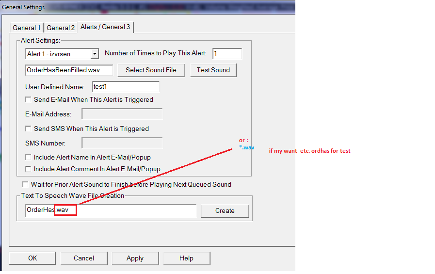

[2015-09-05 13:39:00]
inverter - Posts: 42
I can not get sound when I write letters. what I'm doing wrong? thus save or otherwise? Click All and aply,, still new sound out of the list

[2015-09-08 05:27:13]
We see your Sierra Chart account is expired. You need to renew it and then follow the instructions here to use the Text to Speech function:
General Settings Window: Text-To-Speech Alerts
This feature has an additional cost to it.

[2015-09-08 05:39:34]
Set an alarm for what?
Here is the relevant documentation:
https://www.sierrachart.com/index.php?page=doc/doc_GeneralSettings.html#AlertSoundSettings
We see your account is provided through a broker. So you have to add credit to your Additional Services Balance to use the text to speech feature.
Date Time Of Last Edit: 2015-09-08 05:39:58

[2015-09-11 05:59:40]
The cost of a text to speech sound file is 0.50 USD each.
if I'm understanding ..we have to add money to the account and pay a one-time $ 0.50 per 1 additional sound? or is that a monthly subscription?
so that payments to this account? thank
[2015-09-11 17:09:45]
If you want to use the text-to-speech feature, then the cost is $.50 per sound file.
This is not a monthly subscription.
You need to make the payment to the Additional Services Balance to add credit to use the Text to speech feature:
https://www.sierrachart.com/usercp.php?page=AddAccountCredit
