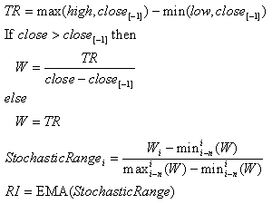

User20851 - Posts: 9
Hi Vegasfoster and all,
I believe the formula would be here:
http://www.csidata.com/images/study_formulas/68.gif
Also, see attachment.
Thanks!

[2013-06-14 03:58:24]
vegasfoster - Posts: 444
It looks slightly different than anything I can recall, so I can do it tomorrow if someone doesn't beat me to it.

[2013-06-14 21:49:33]
I think ganz is right, output looks pretty screwy to me. I double checked the formulas and don't see any errors. On the surface, the W calculation is what seems off to me, but I could be wrong.
attachmentRangeIndicator.dll - Attached On 2013-06-14 21:48:35 UTC - Size: 19 KB - 1023 views
attachmentRangeIndicator.cpp - Attached On 2013-06-14 21:48:46 UTC - Size: 1.45 KB - 1177 views
